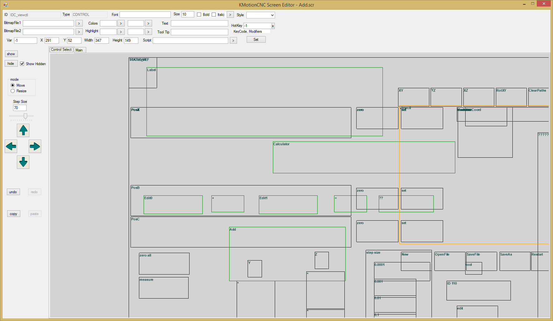

I've also run into a bug with the Screen Editor where the contents of the screen seem to have been scaled (after opening the add.scr). All the controls on the screen editor are very large and it's impossible to size my screen large enough to see them. I think it would be great if the whole "work area" were in a scroll-able view. See the screen shot.

Select the "main" tab and change the Main Dialog Screen Width and Height such to include your controls.I've also run into a bug with the Screen Editor where the contents of the screen seem to have been scaled (after opening the add.scr). All the controls on the screen editor are very large and it's impossible to size my screen large enough to see them. I think it would be great if the whole "work area" were in a scroll-able view. See the screen shot.
