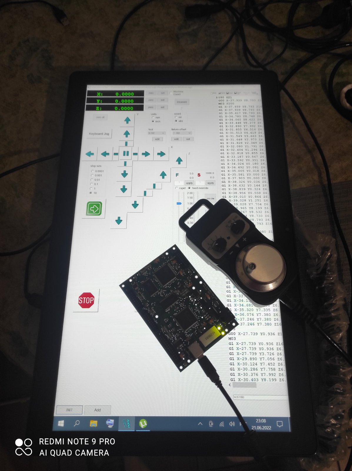

I make my machine control based on the EloPOS monoblock complete with Kflop.Monoblock touch and control menu in KMotionCNC is not convenient for touch input.That's why I'm distracting you for which I apologize.

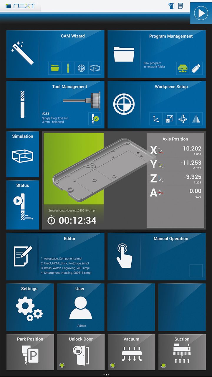

I want to make KMotionCNC controls look like DATRON Dynamics.
The photo below shows a similar menu.
It will not be a one-on-one copy, but it will be similar.
If you do not mind, I will distract you about this?
