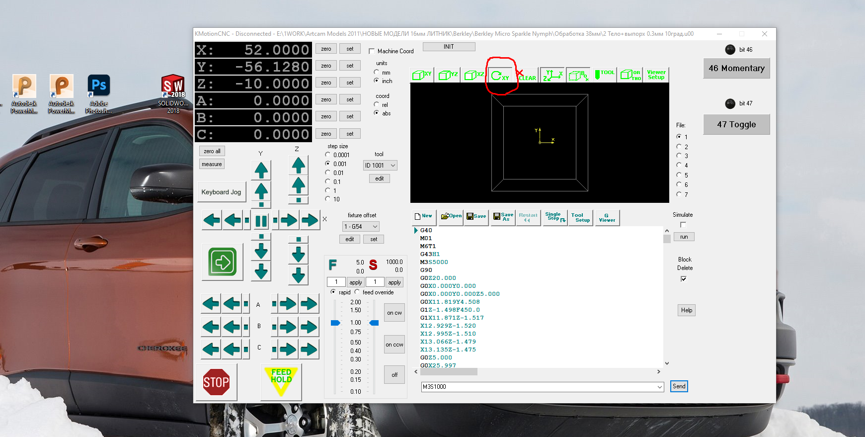

With a mouse, everything is clear, thank you. I thought the view rotation button should work but it doesn't.
Touch input needs such a button.
Tarasevih
Posts: 101
Re: Viewer color
Post by Tarasevih » Wed Jun 22, 2022 4:44 pm
Sorry, I figured out how this button works.
Everything works for mouse input. But you need to add an input mode button for the touch monitor
How can I add this button ?
Taras.

I suppose you could alter the behavior so that whenever the xy Rotation button is down then the Left mouse does normal rotation (instead of translation) and the right mouse does xy rotation (instead of zoom). See the function
void COpenglCtl::OnMouseMove(UINT nFlags, CPoint point)
and related flags:
m_LeftButtonDown
m_RightButtonDown
m_xyRotation (Tool bar button state)

I redid it the way I need it.
// Both : rotation
if(m_LeftButtonDown && m_xyRotation) //&& m_RightButtonDown)m_LeftButtonDown
//if(!m_xyRotation)
m_yRotation -= (float)(m_LeftDownPos.x - point.x) * m_SpeedRotation * TimeFactor;
m_xRotation -= (float)(m_LeftDownPos.y - point.y) * m_SpeedRotation * TimeFactor;
//else
//m_zRotation -= (float)(m_LeftDownPos.x - point.x) * m_SpeedRotation * TimeFactor;
m_LeftDownPos = point;
m_RightDownPos = point;
InvalidateRect(NULL,FALSE);
Now if the button is not pressed, then we move; if it is pressed, we rotate.
This will be more convenient for touch input.
I have one more question. The jog buttons work fine for me only when I double-click. Where can I look in the code to fix this ?
Taras.
