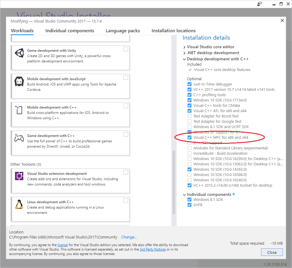

That is telling you afxwin.h is missing which is the main header for MFC (Microsoft Foundation Classes).
Make sure you have installed the option in VS2017 for MFC. See below:

I have installed the MFC for VS2017.
I was then able to compile the BuildAllLibs.sln without errors in VS.NET 2017.

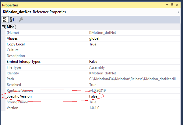

There is a Property in each VS Project reference to use a Specific Version. We have found setting that false can sometimes help. See below:

Also, per your suggestion, I have gone into my simple test application and into the reference to KMotion_dotNet. I then changed its reference property for "Specific Version" to False within my application. This did not seem to help as the same errors continued.
