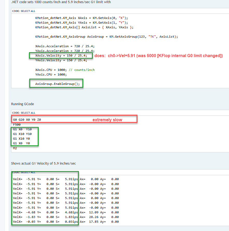

Please see my picture below which may help to understand what I found on my experiments. In Green (G1 related), I agree with you and find that G1 works as expected.
In Red (G0 related), the change done by changes automatically the G0 limit in KFLOP (ch0->Vel is now 5.91, replacing the previous value of 5000 for limiting to 5 inches/s with the resolution of 1000 counts/inch)
=> see below KMotion_dotNet.KM_Axis Velocity property which acts on this parameter.
Now the problem:
Running the Gcode, you should see that G0X0Y0Z0 is slow (maybe you did not see it if KFLOP was already at X0Y0Z0 position).
Please replace your first line by G0 G20 X10 Y0 Z0 to see the too slow G0 move, being limited to 0.00591 inches/s.
XAxis.Velocity = 150 / 25.4; => see below KMotion_dotNet.KM_Axis Velocity property which acts on this parameter.

}Running the Gcode, you should see that G0X0Y0Z0 is slow (maybe you did not see it if KFLOP was already at X0Y0Z0 position).
G20 G01 X5 Y0 Z0 F18000
G0 X10
M2
outputs the following
<Feed=5.90980 units/s ch0->Vel= 5.91> // G1 in progress
<Feed=5.90972 units/s ch0->Vel= 5.91>
<Feed=5.90971 units/s ch0->Vel= 5.91>
<Feed=5.90958 units/s ch0->Vel= 5.91>
<Feed=5.90985 units/s ch0->Vel= 5.91>
<Feed=5.12061 units/s ch0->Vel= 5.91> // G1 ending near X5
<Feed=0.00276 units/s ch0->Vel= 5.91> // G0 starting to X10
<Feed=0.00590 units/s ch0->Vel= 5.91>
<Feed=0.00591 units/s ch0->Vel= 5.91> // G0 at full "low" speed
I did all my experiments considering inches, even if my values are big, those are just examples. Moreover, I don't have motors connected to the KFLOP so my values can be stupid sure.
I use G20 in the tested GCode programs to be sure that the interpreter is in inches.
I hope that my explanation is clear, and that you will also find the G0 issue in your test configuration.
Frederic

I analysed deeper your source code and found the reason in GCodeInterpreter.cpp: The CoordMotion property RapidParamsDirty is not set to True when changing an axis Velocity.
I solved the issue by faking the KFlop in 3 steps:
1/ change Velocity
2/ run an empty Gcode file with the KMotion_dotNet.KM_CoordMotion.Interpreter.Interpret function.
3/ run the StraightTraverse move
The KMotion_dotNet.KM_CoordMotion.Interpreter.Interpret (in Step2 ) runs the code below found in GCodeInterpreter.cpp, which sets RapidParamsDirty to true (meaning a recalculation of the Rapid-StraightTraverse velocity)
Please can we have a smarter way to skip the Step 2 (exposing RapidParamsDirty to .Net with a method or property in KMotion_dotNet.KM_CoordMotion)?
KMotion_dotNet.KM_CoordMotion.StraightTraverse(...)
Change XAxis.Velocity to 3 as an example, and run another StraightTraverse move.
The move still will run at 5.91 and not 3.
=> The new Velocity value is not used by KFlop.
1/ change Velocity

- Posts: 2955
Re: Limit Feedrate in GCode G1
Hi Frederic,
Here is a patch for V5.3.6 which hopefully straightens things our with the KM_Axis/KM_AxisGroup classes.
Copy the dlls from here to the KMotion\Release folder. The changed sources are also there if needed.
Here is a description of the changes:
Fix bug with KM_IO.SetAnalogValue(int value)
Expose Interpreter.SaveVars to save the GCode Interpreter Variables to disk which include fixture and global offsets.
Expose CoordMotion.RapidParamsDirty to force refresh of Rapid axis parameters from KFLOP/Kogna
Expose DoRapidsAsFeeds which breaks down Rapids into small segments which is necessary for non-linear kinematics so that Rapids follow a straight line in CAD Space (which is curved in actuator space).
Fix Issues with KM_Axis and KM_AxisGroup:
1. Velocity and Acceleration will be in 'Units' (inches or mm) and represent the values for Independent motions, Jogging, and G0 Rapids.
2. Jerk will be added to be complete and will be in 'Units' as well.
3. When set these values will be written to KFLOP/Kogna multiplied by the CPU (Counts/per unit)
4. 2 new Parameters CoordVelocity and CoordAccel will be added for Coordinated Motion and be in 'Units'
5. Changed KM_AxisGroup property name from Velocity to FeedRate
6. A new Boolean, CPU_is_mm will be added to indicate if Units are mm, otherwise Units are Inches, which will be used within EnableGroup to set the MotionParameters in inches appropriately
Here is the example code that I tested:
Please let us know if you find any issues
KMotion_dotNet.KM_Axis XAxis = KM.GetAxis(0, "X");
KMotion_dotNet.KM_Axis YAxis = KM.GetAxis(1, "Y");
KMotion_dotNet.KM_Axis[] AxisList = { XAxis, YAxis };
KMotion_dotNet.KM_AxisGroup AxisGroup = KM.GetAxisGroup(123, "TK", AxisList);
XAxis.CPU = 1000; // counts/inch (must set first)
XAxis.CPU_is_mm = false; // (actually not necessary as default is inches)
YAxis.CPU = 1000;
YAxis.CPU_is_mm = false;
// set rapid 3rd order parameters
XAxis.Jerk = 280; // inches/sec3
YAxis.Jerk = 280;
XAxis.Acceleration = 28; // inches/sec2
YAxis.Acceleration = 28;
XAxis.Velocity = 5.9; // inches/sec
YAxis.Velocity = 5.9;
// set Coordinated motion 2nd order parameters
XAxis.CoordVelocity = 3; //inches/sec
XAxis.CoordAccel = 30; // inches/sec2
YAxis.CoordVelocity = 3; //inches/sec
YAxis.CoordAccel = 30; // inches/sec2
AxisGroup.EnableGroup();
