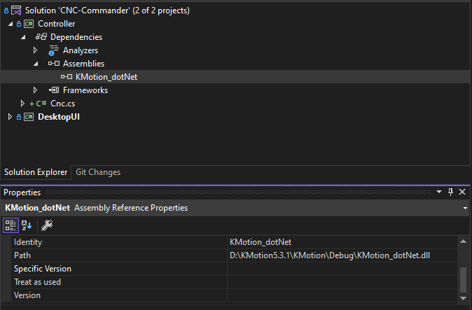

Hello,
I am getting an error when trying to reference the KMotion_dotnet on a .NET 6.0 project. It states that it is not possible to load file or assembly.
Is there a workaround that I can do in this situation?
Here you can see the reference to the dll:
Sincerely,
Guilherme

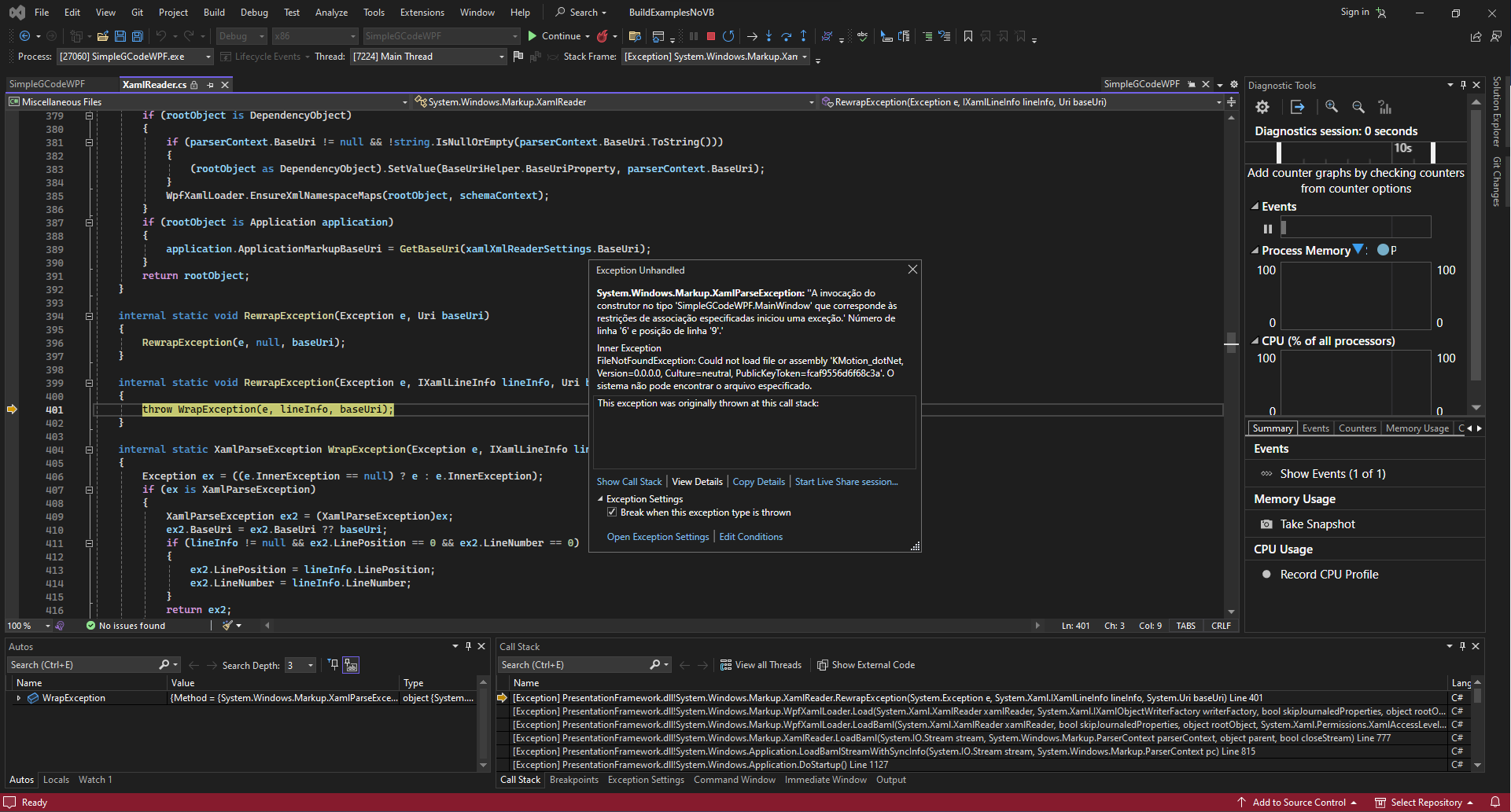

I tested upgrading SimpleForms and it worked. However, the same is not true for SimpleGCodeWPF, which is issuing the same error as my app does.
Sincerely,
Guilherme

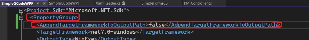

I noticed code was being placed in C:\KMotion5.3.1\KMotion\Debug\net7.0-windows instead of C:\KMotion5.3.1\KMotion\Debug. Running from VS gave the KMotion_dotNet.dll error. But looking at the inner exception details it shows a root problem loading KMotion_dotNet_Interop.dll I think VS is running from thenet7.0-windows folder which doesn't contain KMotion_dotNet_Interop.dll
I found 2 solutions:

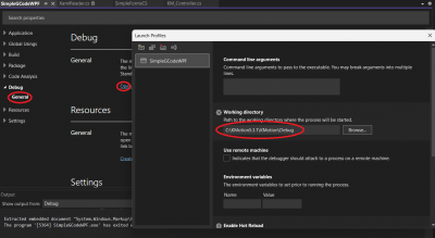

#1 - tell VS to set the working directory to C:\KMotion5.3.1\KMotion\Debug so it finds all the necessary dlls.
#2 - is probably the better solution is to place the output properly in C:\KMotion5.3.1\KMotion\Debug. There doesn't seem to be any way to stop from appending the Target Framework folder for the output except by manually editing the C# project file. Within the PropertyGroup set the AppendTargetFrameworkToOutputPath to false.
Note there seems to be an issue/bug in VS2022 where right click project | Edit Project File sometimes doesn't appear in the context menu unless the project is unloaded first.

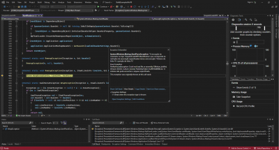

I am currently using VS 2022 (64-bit) V 17.8.6, which indeed has the Upgrade Assistant.
I installed the SDKs that you mentioned and retried the process, but still the error persisted. I also noticed that the code was being placed inside the folder you pointed, and tried the workarounds proposed, which were not successful. :cry:
I don't know what else I could be missing in the upgrade.
