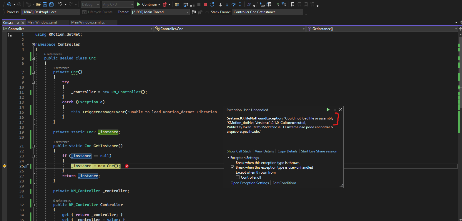

Hello,
I am getting an error when trying to reference the KMotion_dotnet on a .NET 6.0 project. It states that it is not possible to load file or assembly.
Is there a workaround that I can do in this situation?
Here you can see the reference to the dll: Sincerely,
Guilherme
Guilherme

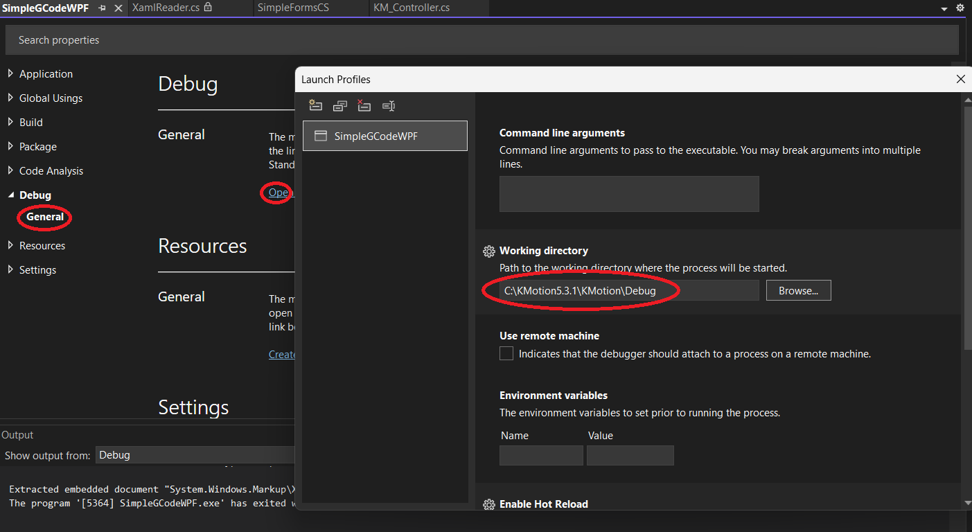

I noticed code was being placed in C:\KMotion5.3.1\KMotion\Debug\net7.0-windows instead of C:\KMotion5.3.1\KMotion\Debug. Running from VS gave the KMotion_dotNet.dll error. But looking at the inner exception details it shows a root problem loading KMotion_dotNet_Interop.dll I think VS is running from thenet7.0-windows folder which doesn't contain KMotion_dotNet_Interop.dll
I found 2 solutions:
#1 - tell VS to set the working directory to C:\KMotion5.3.1\KMotion\Debug so it finds all the necessary dlls.
#2 - is probably the better solution is to place the output properly in C:\KMotion5.3.1\KMotion\Debug. There doesn't seem to be any way to stop from appending the Target Framework folder for the output except by manually editing the C# project file. Within the PropertyGroup set the AppendTargetFrameworkToOutputPath to false.
Note there seems to be an issue/bug in VS2022 where right click project | Edit Project File sometimes doesn't appear in the context menu unless the project is unloaded first.
