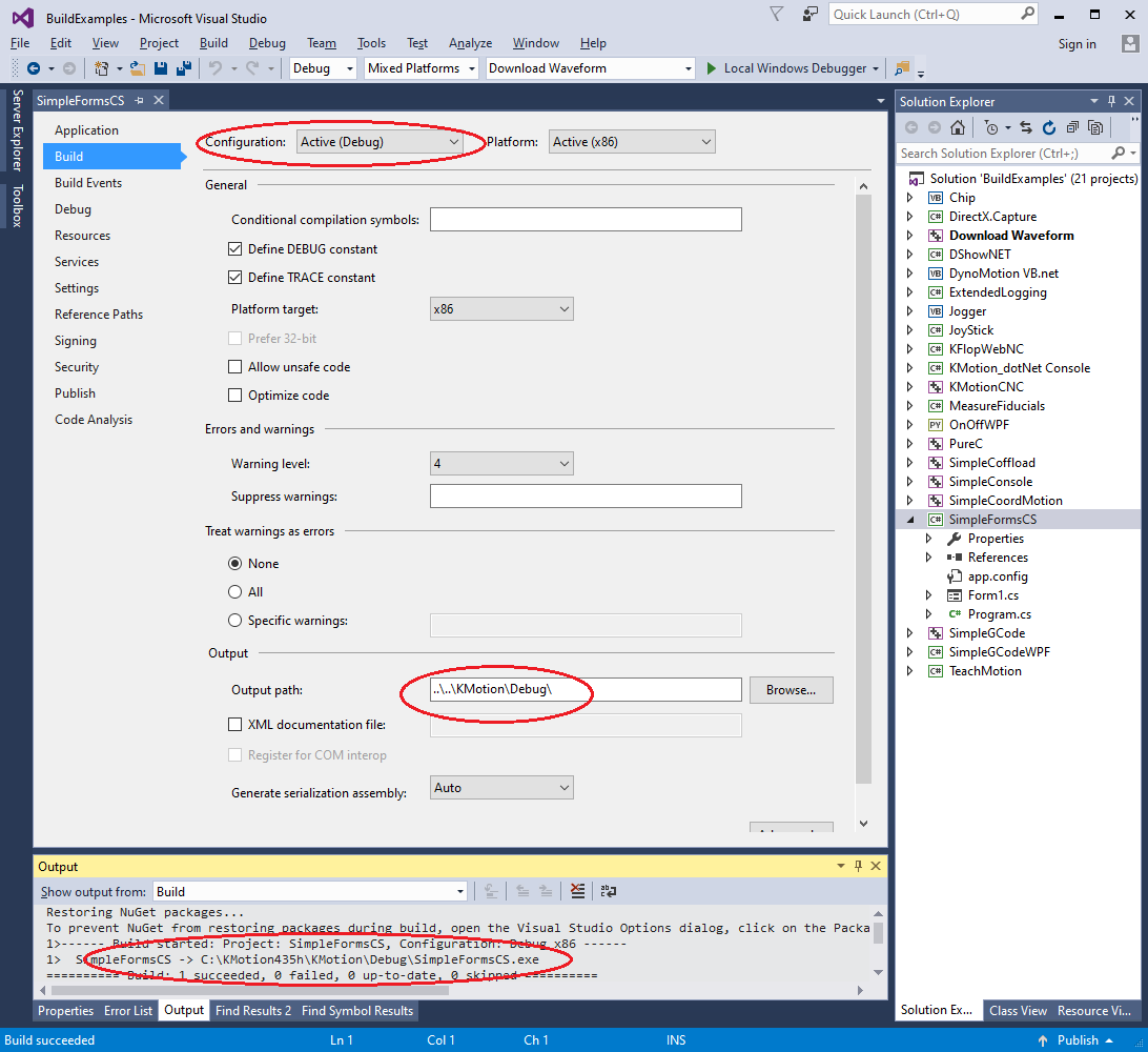

KMotion_dotNet.dll should be in the same folder as the .exe you are trying to run. If you’re running a Debug configuration you should rebuild the libraries with Debug configuration. Use BuildAllLibs.sln.

That will work fine but you shouldn't need to do that. Did you check where your .exe was actually being placed? Sometimes when VS projects are upgraded for new Versions VS changes where the output is to be placed.

The .exe of the example you are trying to run. For the example SimpleFormsCS it would be SimpleFormsCS.exe

I think the simplest thing is to target your binary to be placed with all KMotion’s binaries.

I've moved the Release build directory, so my app can be contained within it's own directory within the main KMotion5.3.1 directory (i.e. c:/KMotion5.3.1/KMoCNC/), just so everything is more contained.
If I set the build directory to the main KMotion/Release directory, everything works as it should, which I'll use for just now.
