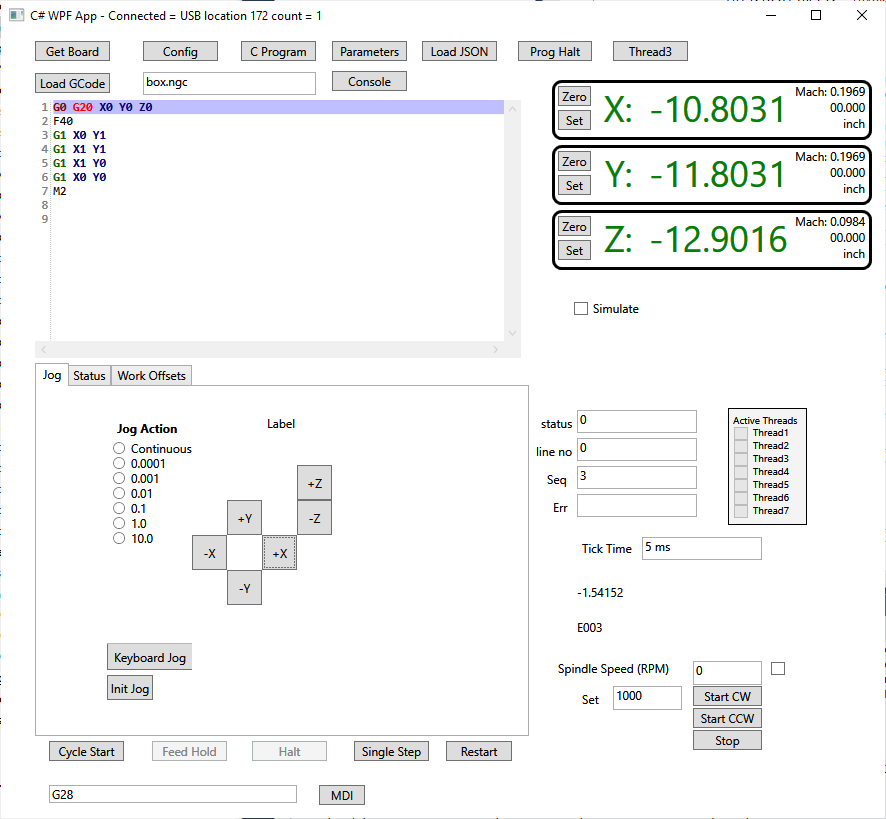

For the past few months I have been working on writing a .Net application similar to your KMotionCNC. I started with the SimpleGCodeWPF example and it evolved from there.
I have been trying to copy a lot of the functionality of KMotionCNC and have so far been fairly successful. I can currently home my machine, Jog with buttons or my MPG, the Spindle responds to M3, M4, M5 and S commands and I can load and execute GCode. I have a manual G Code line working, and I can single step Feed hold, move forwards and backwards in feedhold (your solution for this is quite clever!) and can halt and resume.
But I am having a problem with the halt and resume. I re-implemented the section from KMotionCNC that checks to see if the position has changed since the interpreter was halted, trying to copy what was done in KMotionCNC. My CheckforResumeCircumstances method looks like this.

This mostly works. The problem that I am having is that when the Move to safe Z height is selected
When I have Move to save Z height selected the interpreter halts again and gives a message that says "Soft Limit Z - Rapid Traverse Job Halted" It then resets interpreter back to the beginning of the GCode file.
It doesn't seem to matter what number I put in for the safe z height or the state of ResumeSafeRelAbs, if the safe Z height is selected it gives me the error, if it is not selected everything else works.
When I try to do the same thing in KMotionCNC with the same KFLOP C code, ie run a small GCode program, halt, jog a bit and resume, KMotionCNC runs without a hitch.
Any help would be appreciated!

you can see the current state of the machine here:
This is very much a work in progress but I'm having a good time with it.
