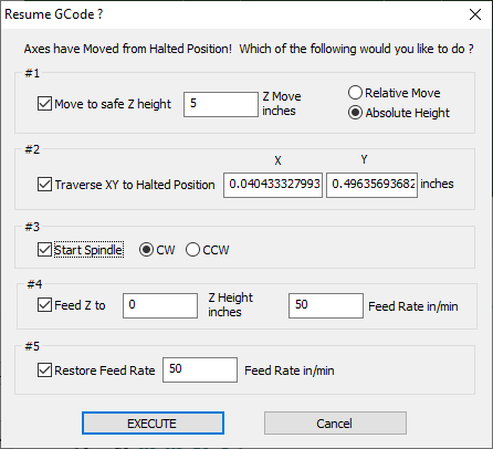

Consider using the Halt mechanism that KMotionCNC uses. This allows instant halting and resuming. Halting the Interpreter handles most of the messy details for you. The Halt mechanism in the Interpreter immediately performs a FeedHold. It then rewinds the Interpreter (from the lookahead) back to the exact point the motion came to a stop. It records enough information to allow automatically resuming from that point as long as nothing is moved.
KMotionCNC has code to check if it is resuming after a halt and something has been moved. If so, it prompts the Operator on how it should move back to the point it was. This information can then be set into the Interpreter for it to be executed when the Interpreter begins. See the "Resume" methods in the Interpreter Class. Another option may be to simply not allow to resume if anything moved. You might see the KMotionCNC C++ CheckForResumeCircumstances() function.
