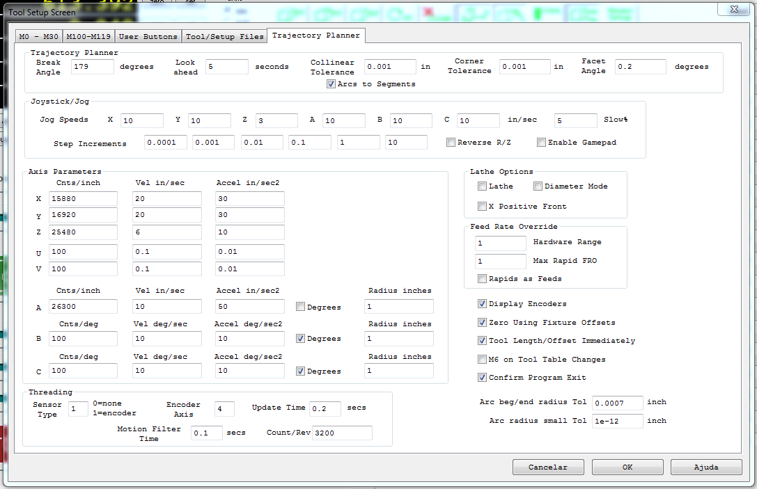

Same error now with a slighty different file
attached also TP config.

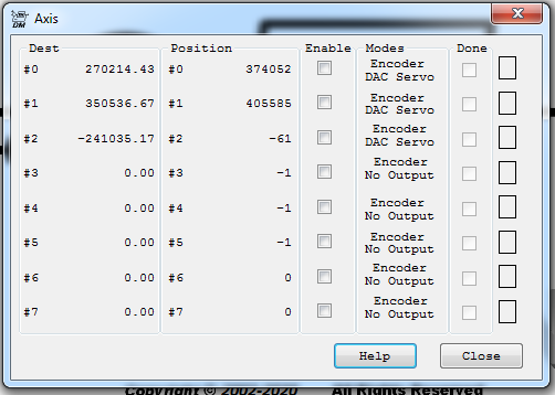

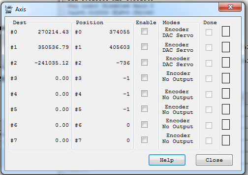

MDI G1 G53 Z0 F1000
machine went to Z0.7 and stopped,
axis dimensions where as photo init again, the dimensions where the same in dest and pos
MDI G1 G53 Z0 F1000 again
axis dimensions where as photo Init again, axis dimensions fine, can move with jog, if mdi or start program, ERROR!
Also got this code in console
MoveEx Failed! chan=0 a0=0 v0=0 dx=1.00001e-06 MaxVel=0 Accel=990000 Decel=990000 Jerk=3.5e+06
MoveType:INVALID_ZERO_NEG_CONSTRAINT
Following Error Disabled Axis:0

Facet angle of 0.2 degrees is very small. That causes every 90 degree angle to generate 450 segments. We recommend 1 degree or higher. But this should only cause the machine to slow down not disable. KFLOP can process ~ 2000 motion segments/second.

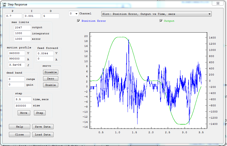

Hi Tom. the system runs perfect with facet angle of 0.3, also its using a feed of ~1000mm/min for the specified g-code operation.
the machine is capable of around 30in/sec.
here is a plot of it doing ~23in/sec

For the facet angle, I was trying to eleminate jerk with g-codes created from splines, this is why i used a low facet angle, will use 0.5 by now.

Very fast machine. Btw it is good to also post the raw data. That way we can re-plot it to show Velocity, zoom in, etc. An error plot alone doesn't tell us much.here is a plot of it doing ~23in/sec
