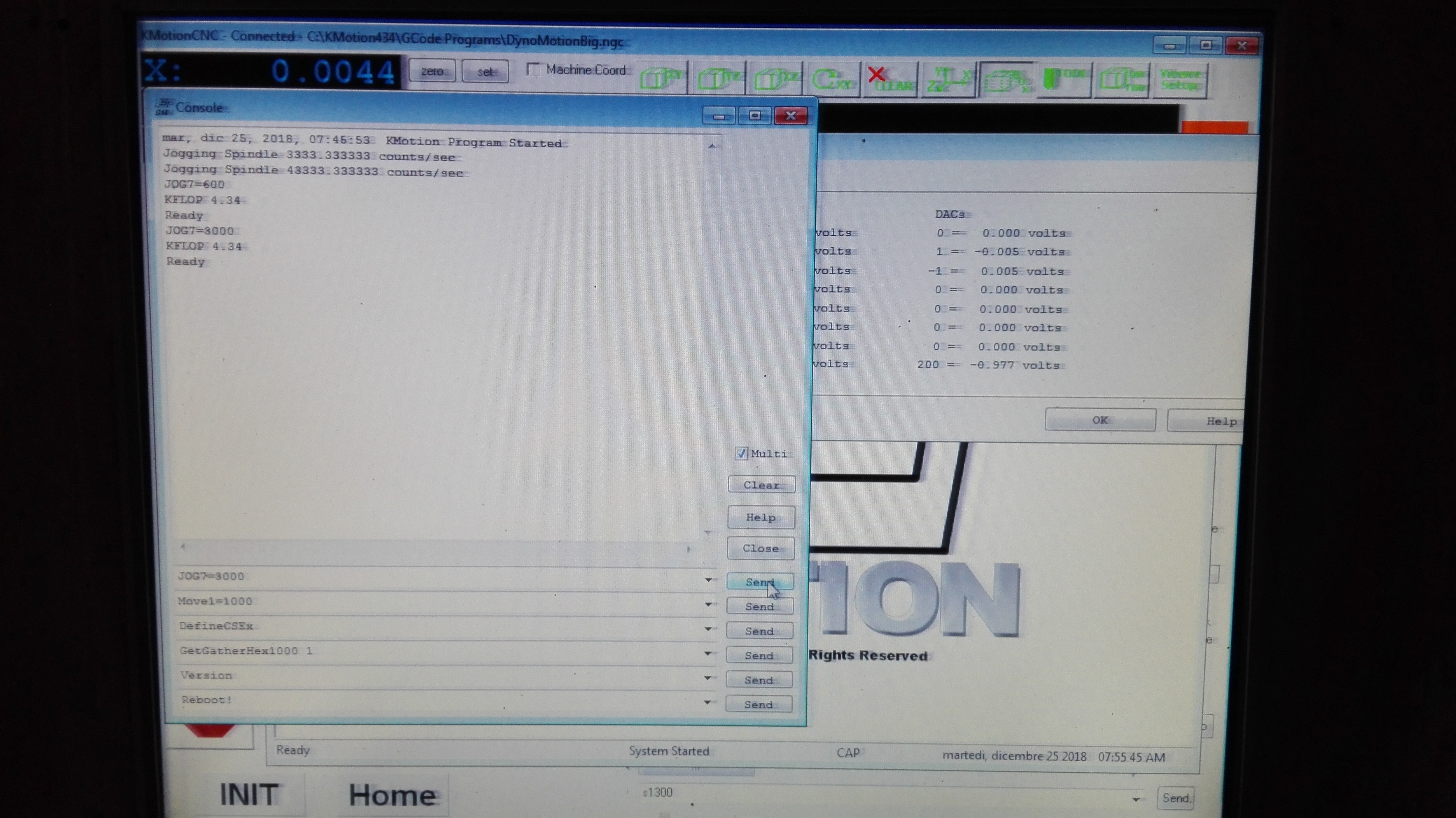

Everything is working normally except the S command: M3, M4 and M5 are working and the Spindle start, reverse and stop in accordance with buttons but the S command doesn't change anything. Opening Analog Status I read a fixed value around -1V on DAC #7 and if i change S, the DAC value doesn't change. But i can see from Console that the count per sec are changed.

Do you have KFLOP Axis #7 configured to use DAC #7?
If you Jog Axis #7 from the Console Screen does the Speed Change. Ie. Jog7=10000
If you Post your S Program, MySpindleDefs.h, and a screen shot of how you have S configured in KMotionCNC | Tool Setup we can check it over

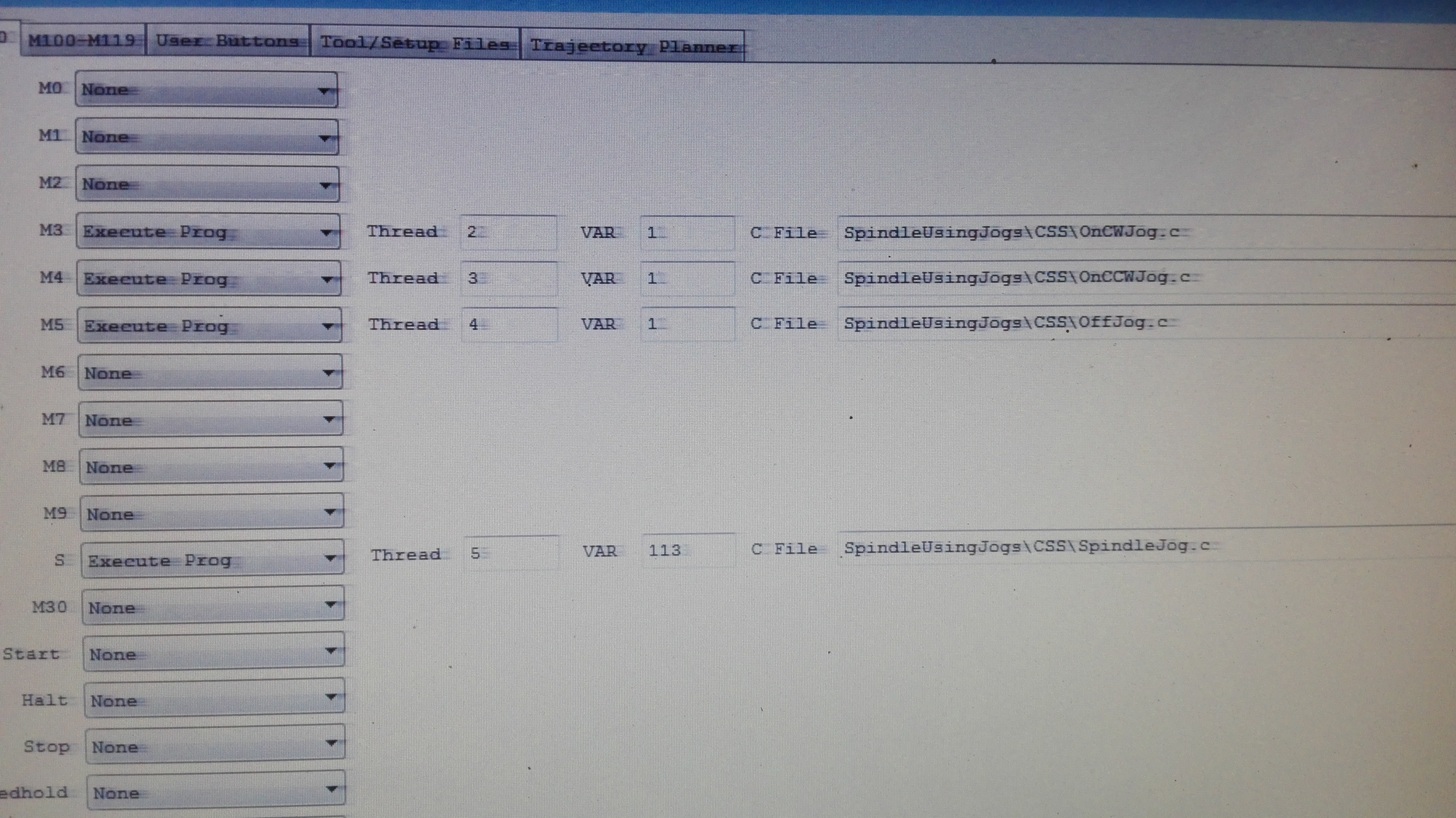

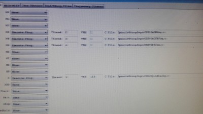

Re: S command doesn't work properly
While waiting I send the requested, can you let me to well understand two things? In particular:
1) in KmotionCnc Tool setup screen, M0-M30 folder, button set as "Execute Prog", the VAR field witch value must to assume?

- Posts: 2931
Hi Beppe,
#define KMVAR PC_COMM_CSS_S // variable KMotionCNC will pass speed parameter (113)
#define PC_COMM_CSS_S 113 // S speed setting in inches/sec
The Var field must match the C Program. Normally 113 as set by:1) in KmotionCnc Tool setup screen, M0-M30 folder, button set as "Execute Prog", the VAR field witch value must to assume?

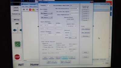

good morning Tom,
attached my setting files. Jog command doesn't change Spindle speed, S command in KmotionCnc change the jogging speed but the Dac has the same value.
Waiting your suggestion...
Beppe
Beppe

If Jogging Axis 7 doesn't move the Spindle then Axis 7 is not configured properly or Axis 7 is not enabled.
Is Axis #7 Enabled? Check the Axis Screen.
How is Axis #7 configured. See the Config/Flash, Step Response, and Filters Screen. It should be configured as described here.

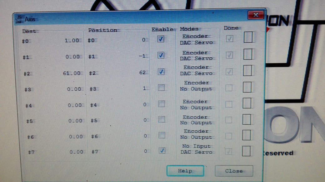

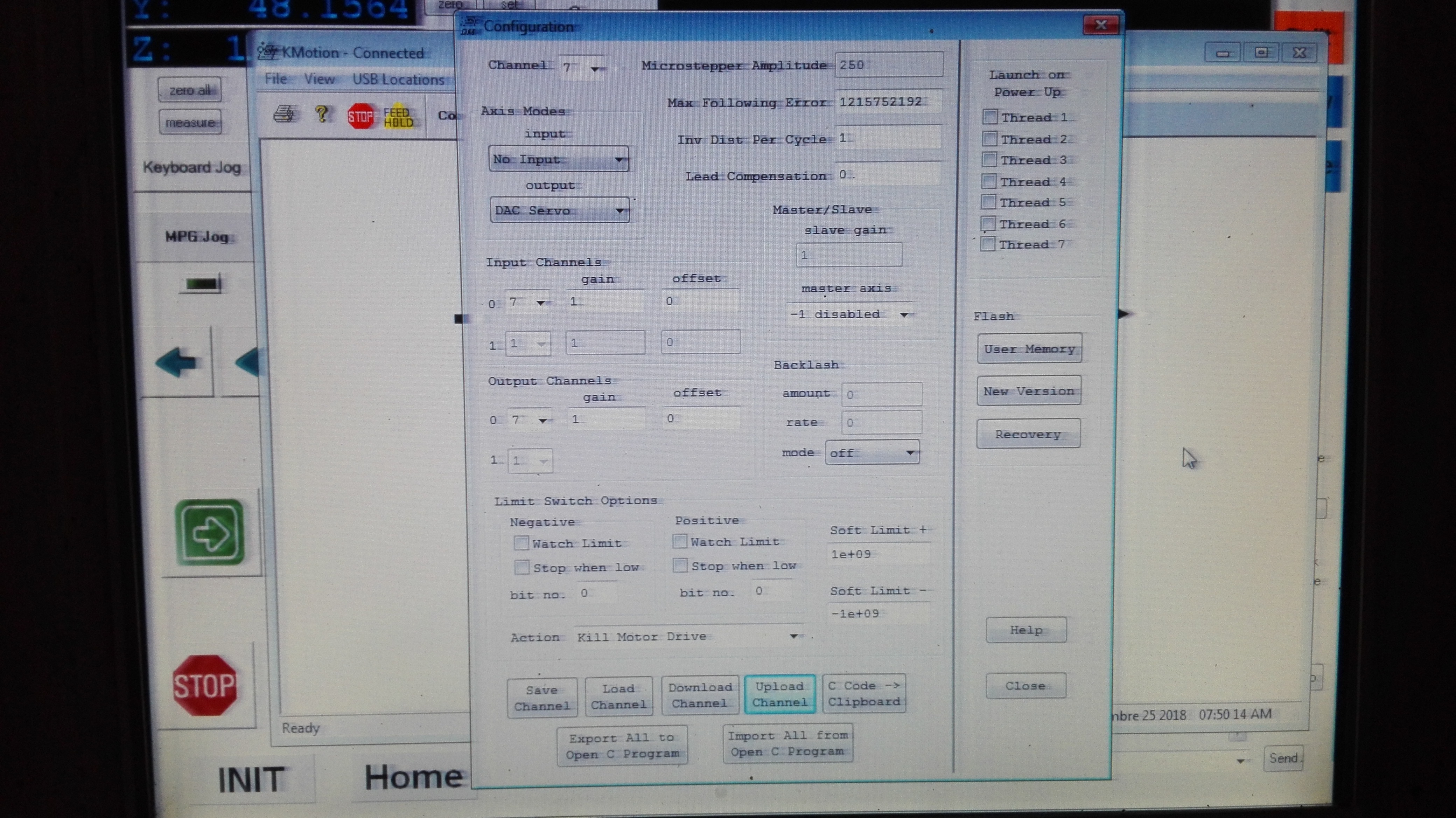

hi Tom,
in the Channel 7 configuration picture I sent before do you see something wrong? I uploaded from Kflop the configuration then I am sure about channel 7 status. In the picture below you can see that axis #7 is enabled. Did you ceck my C configuration files? It's all as requested?

- Posts: 2931
Hi Beppe,
Axis #7 is not configured properly with regard to the Step Response Screen Parameters FF and PID. Please read the link in my last post.
