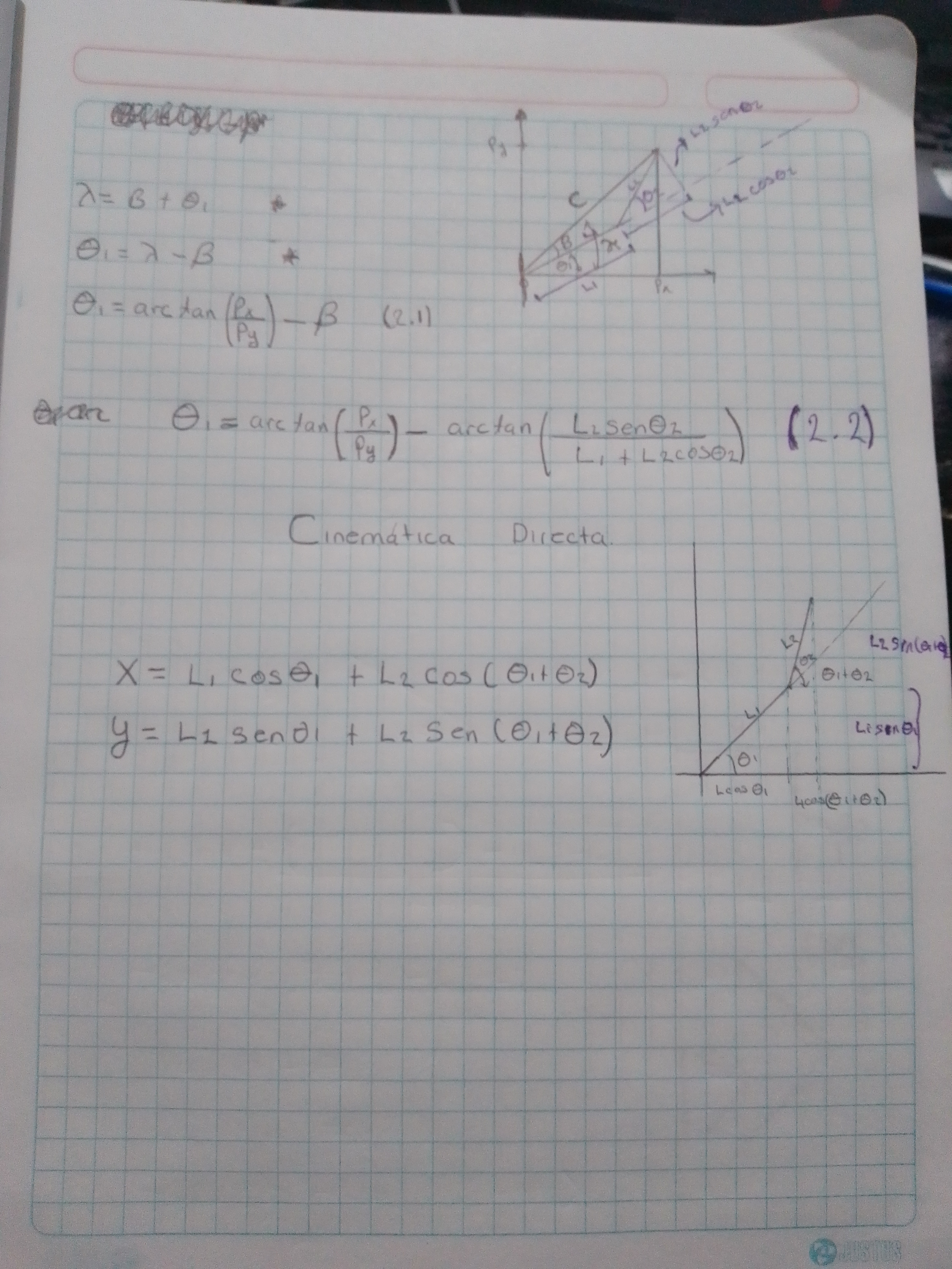

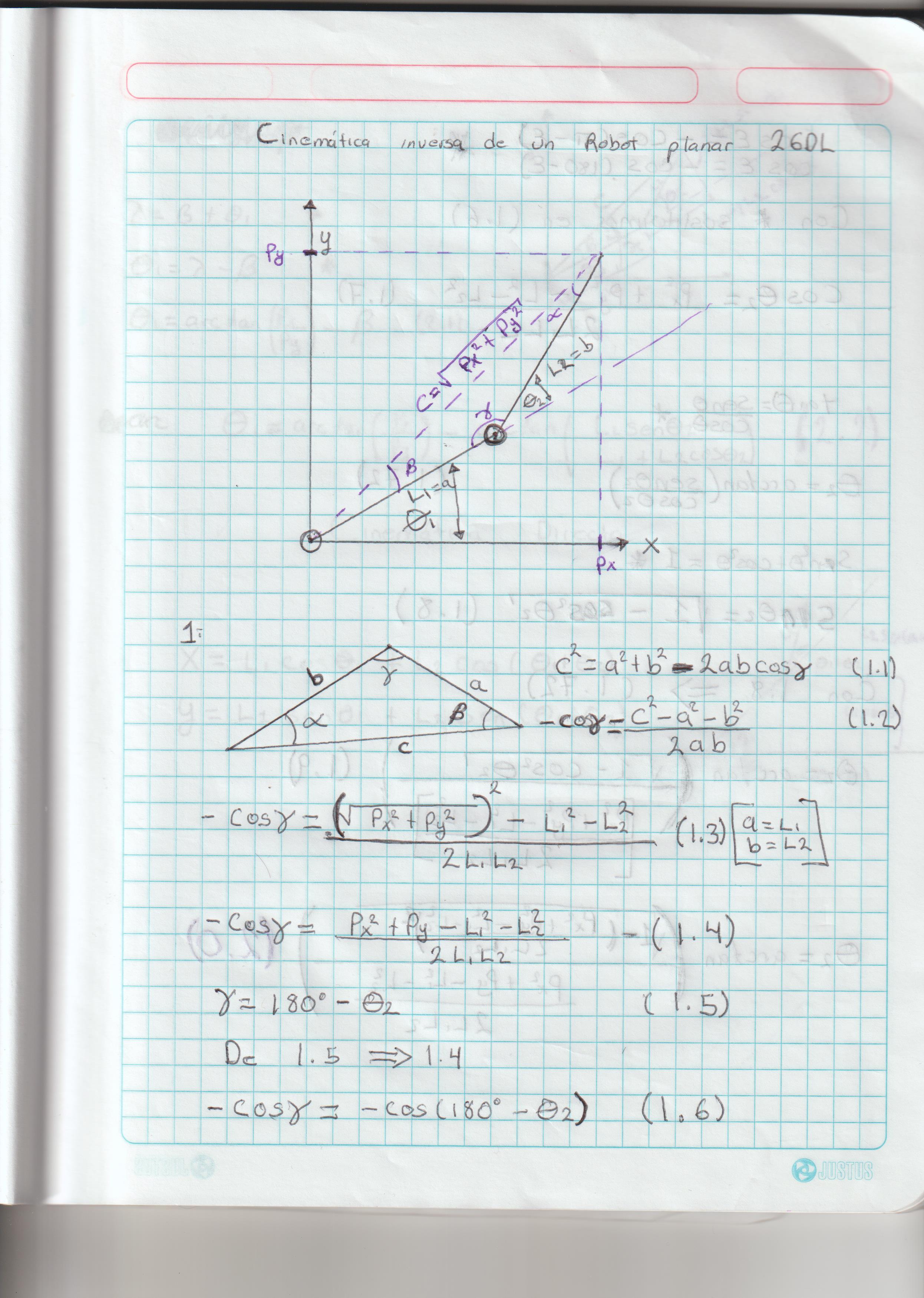

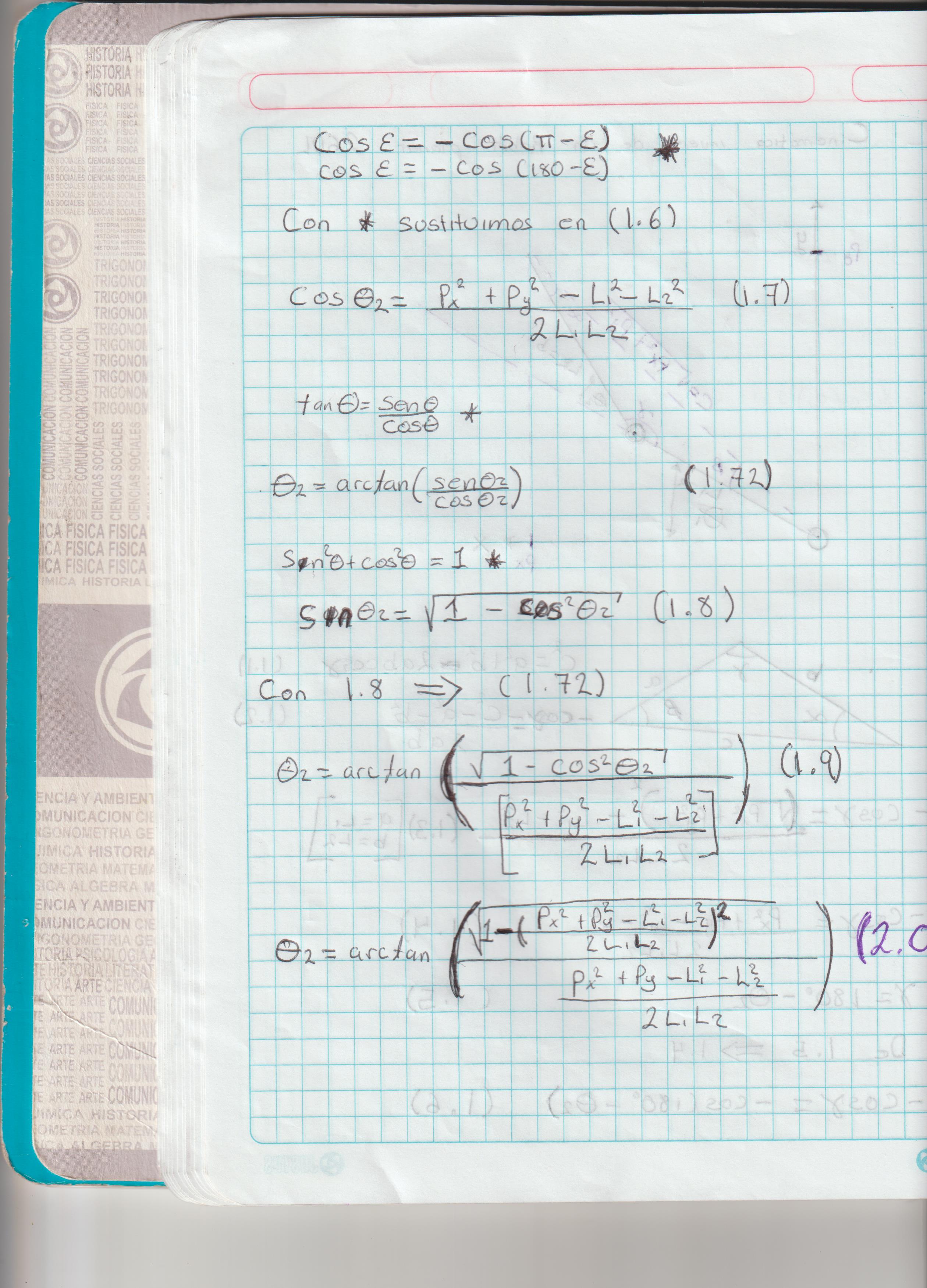

Hello, Tom
I am trying to load a new kinematics, I have followed the steps that you indicate in other comments.
I have the following
1) Direct kinematics equations.
2) Equations inverse kinematics.
3) Class (.h and cpp files).use KinematicsScara as a guide.
attached documents
I add the screenshots of what I did to add the new class.
Could you help me please, I don't know if I'm doing it right or if I'm doing strange things.I'm new to this.
attached documents
Once I have all the files, I click debug but I can't get the robot to work properly.TomKerekes wrote: ↑Sun May 17, 2020 5:32 pmHi geraldft,
