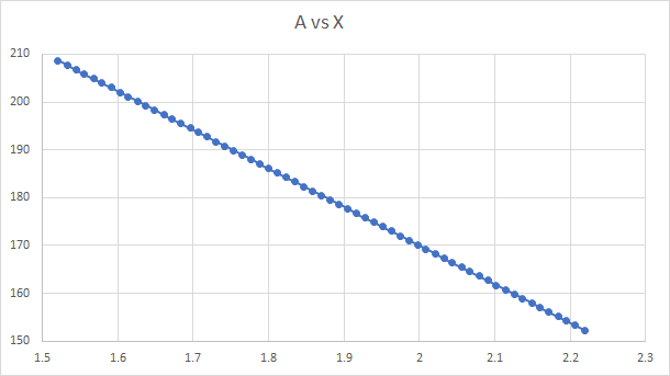

I've never seen CAM output bursts of short Rapids like that. KMotionCNC only combines/smooths Feeds not Rapids. Rapids will be handled as 3rd order exact stop type of moves. I can't imagine why the CAM would do that. Especially since they appear to be forming a perfectly straight line. The CAM looks to be limiting the rapids to less than 1 degree of motion. For example starting at line 195 (see below). All the intermediate Rapids should be able to be removed at no consequence. Here is a plot:

Example data starting at line 195
G00Z5.186
G00X2.219A152.302
G00X2.207A153.241
G00X2.195A154.180
G00X2.184A155.119
G00X2.172A156.058
G00X2.160A156.997
G00X2.149A157.936
G00X2.137A158.875
G00X2.126A159.814
G00X2.114A160.753
G00X2.102A161.691
G00X2.091A162.630
G00X2.079A163.569
G00X2.067A164.508
G00X2.056A165.447
G00X2.044A166.386
G00X2.033A167.325
G00X2.021A168.264
G00X2.009A169.203
G00X1.998A170.142
G00X1.986A171.080
G00X1.975A172.019
G00X1.963A172.958
G00X1.951A173.897
G00X1.940A174.836
G00X1.928A175.775
G00X1.916A176.714
G00X1.905A177.653
G00X1.893A178.592
G00X1.882A179.531
G00X1.870A180.469
G00X1.858A181.408
G00X1.847A182.347
G00X1.835A183.286
G00X1.823A184.225
G00X1.812A185.164
G00X1.800A186.103
G00X1.789A187.042
G00X1.777A187.981
G00X1.765A188.920
G00X1.754A189.858
G00X1.742A190.797
G00X1.730A191.736
G00X1.719A192.675
G00X1.707A193.614
G00X1.696A194.553
G00X1.684A195.492
G00X1.672A196.431
G00X1.661A197.370
G00X1.649A198.309
G00X1.637A199.247
G00X1.626A200.186
G00X1.614A201.125
G00X1.603A202.064
G00X1.591A203.003
G00X1.579A203.942
G00X1.568A204.881
G00X1.556A205.820
G00X1.545A206.759
G00X1.533A207.698
G00X1.521A208.636

As a workaround I just did a global replace of "G00" with "G01F10000" and the file seemed to run pretty well for me. The small in-line rapids are then combined and executed without stops. All the existing G01's all seem to have feedrates of F100 so I think it works ok.
