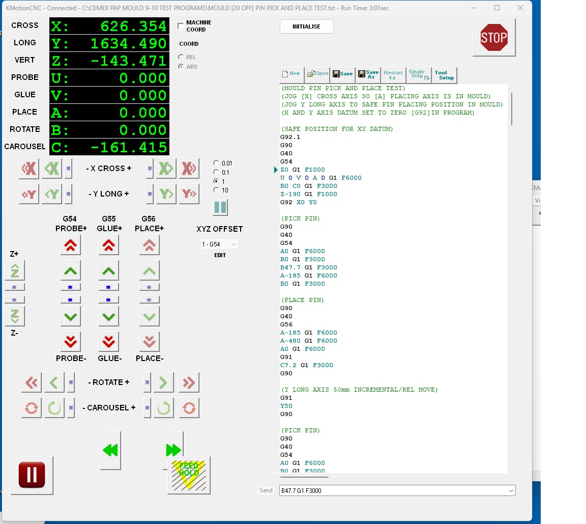

I have attached a screen shot of my 8 axis screen.
on Fed hold two sets of arrows are displayed.
Where do they come from and how can i remove them please ?

Hi Tim,
This is a powerful feature of KMotionCNC which is the ability to move forward and backward along the GCode Path while in Feed Hold. They automatically become visible while in Feed Hold. We don't currently have a way to disable this. You could move them outside of your screen area to make them invisible.
