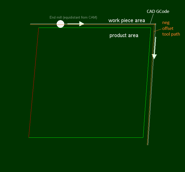

Neg Offset.png (11.15 KiB) Viewed 54481 times
Could you answer my questions?

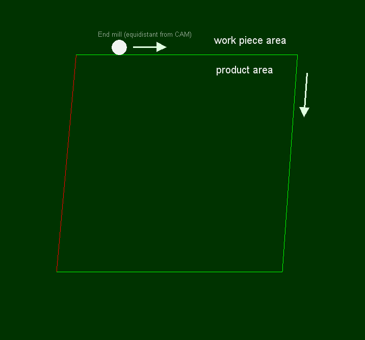

The products has a variety of geometries, and manually adding arcs is not advisable. This will increase the possibility of errors in the geometry. In addition, it will significantly increase the design time.
Aren't you using CAD? It should add the arcs without possibility of error.
