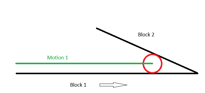

Post by TomKerekes » Fri Jun 27, 2025 1:26 am
Hi Alexanders,
That would be technically incorrect and is difficult to implement because one block of motion can't be determined until the following block of motion is known. Block 1's motion can't be determined before Block 2. Also if Block 1 or 2 consists of multiple small blocks the result is somewhat indeterminate.
Your example of 86 degrees isn't really relevant is it? Any angle less than 180 degrees would cause gouging correct?
Which CNC systems support this?
Why doesn't adding arcs suit you?
One workaround might be to create the GCode slightly undersized such that all corrections would be positive. Would that work for you?
If you really need this to be added would you be willing to fully test it? There would be a number of special cases. Single stepping would execute delayed. A embedded MCode between compensated moves would either need to execute before the last motion or otherwise allow a gouge.

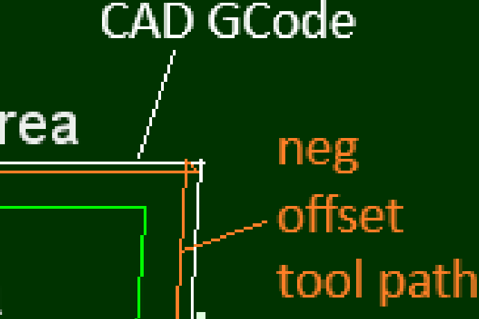

Post by TomKerekes » Mon Jun 30, 2025 5:33 pm
This is a bad path. Other program elements do not allow this.
I don't understand what you mean.
But I think all the issues still exist.
Neg Offset.png (11.15 KiB) Viewed 54453 times
Could you answer my questions?

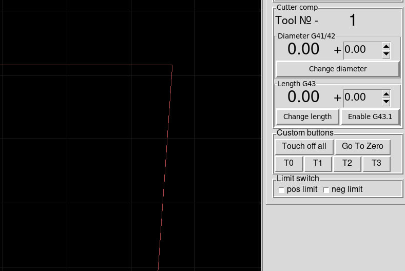

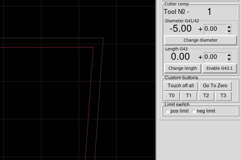

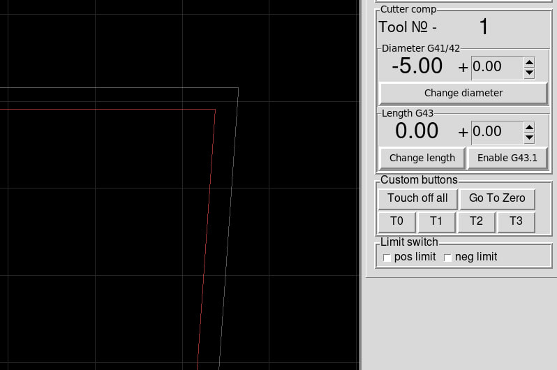

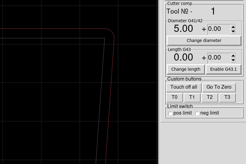

Here are examples of running the same program in LinuxCNC:
Zero tool compensation:
Positive tool compensation:
Negative tool compensation:
No concave angle errors occur.

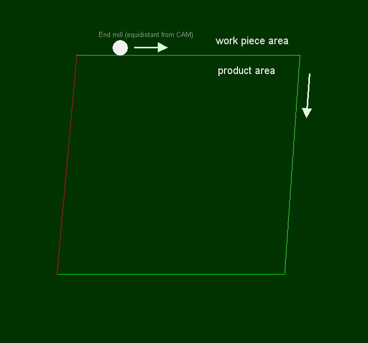

Because the product should have a sharp corner, without a radius.
With an arc less than the tool the corner will always be sharp.
The products has a variety of geometries, and manually adding arcs is not advisable. This will increase the possibility of errors in the geometry. In addition, it will significantly increase the design time.
Aren't you using CAD? It should add the arcs without possibility of error.
