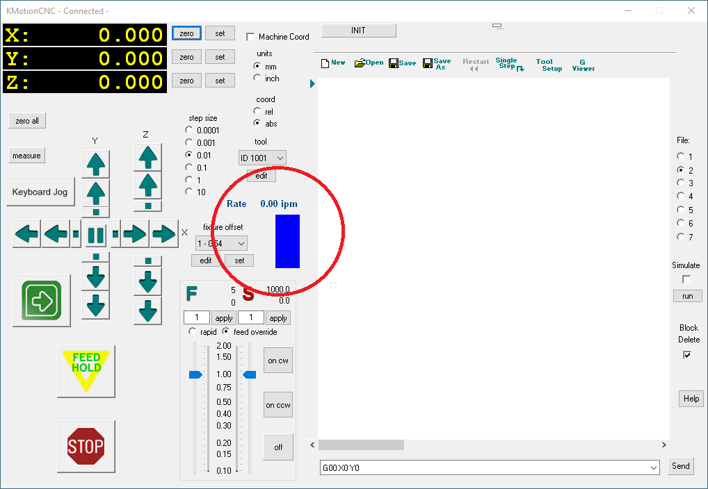

is it possible to display an ADC value on the KMotionCNC screen?
If possible as some kind of bar or percentage, in my case to show spindle load.

Hi Thomas,
Yes. You might see the Screen example ShowInstantFeedRate3AxisBar.scr that shows the feed rate as a value and as a Bar Graphic.
The C Program example ShowInstantVelocityDROBar.c updates the Value and the Bar Graphic periodically.
You can read the current value of a Kanalog ADC with ADC(n).
You can use KOGNA_CONVERT_ADC_TO_VOLTS(v) to convert the ADV counts to Volts if needed.
#define CNTS_PER_INCH_X 20000.0
#define CNTS_PER_INCH_Y 20000.0
#define CNTS_PER_INCH_Z 15000.0
#define FULL_BAR_SCALE 50.0
	double Rate,d,x0,dx,y0,dy,z0,dz,t0,t1;
	char s[80];
	for(;;)
		t0=WaitNextTimeSlice();
		x0 = ch0->Dest / CNTS_PER_INCH_X;
		y0 = ch1->Dest / CNTS_PER_INCH_Y;
		z0 = ch2->Dest / CNTS_PER_INCH_Z;
		t1=WaitNextTimeSlice();
		dx = ch0->Dest / CNTS_PER_INCH_X - x0;
		dy = ch1->Dest / CNTS_PER_INCH_Y - y0;
		dz = ch2->Dest / CNTS_PER_INCH_Z - z0;
		d = sqrt(dx*dx + dy*dy + dz*dz);
		Rate = d/(t1-t0)*60.0;
		sprintf(s,"Rate %8.2f ipm\n",Rate);
		// Put it onto the Screen
		DROLabel(1000, 162, s);
		WriteVarFloat(163, Rate/FULL_BAR_SCALE);
		Delay_sec(0.5);
