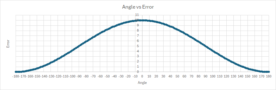

Post by TomKerekes » Mon Jun 24, 2024 2:15 am
Hi Thomas,
Here is a patch for V5.3.3 that should add a Table mapping feature to a linear Axis such as this:
There is a description in our wiki here.
The change is to the Kinematics in the GCodeInterpreter.dll Library.
Download and copy this file to the \KMotion5.3.2\KMotion\Release folder.
Please let us know of any issues.
