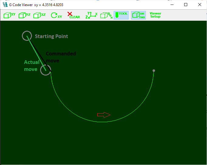

Its not clear what you are trying to do. The GCode you provided is a CCW arc. Uncompensated would be this:
You didn't tell us the Tool Diameter. G42 will compensate to the right of contour. So I expect you desire the tool to pass over the outside of the arc.
The G42 GCode Block should contain an entry linear move to the beginning of the contour over which the compensation will be applied. The actual linear move will be to where the tool is tangent to the specified contour. Note the entry move is delayed because the direction of the contour needs to be known to determine the tangent position.
Shown here is a 2mm Tool placed tangent to the beginning of the contour you specified.
The next question would be the tool starting point before moving to be tangent to the contour? The starting point can be anywhere including the start of the contour. But that wouldn't normally make sense as it would gouge the contour that we are trying to create. Normally it would be away from the contour and in the direction of the contour such as shown here X=-2 Y=3:
The corresponding GCode would be:
G40
N1 G21 G54 G17
N2 G0 X-2 Y3 (Starting Point)
N3 G1 G42 D1 X0 Y0 F500  (Entry move to beginning of contour)
N4 G3 X10 Y0 I5 J0 (First compensated contour motion)
N5 M30
Resulting in this tool path:
