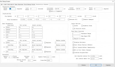

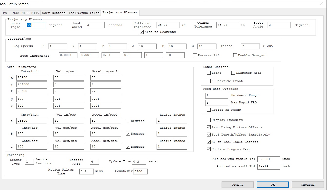

TomKerekes wrote:
Tue May 02, 2023 4:40 pm
Please post yourTrajectory Planner Settings.
Posts: 2892
Re: elay in subprograms
Post by TomKerekes » Fri May 19, 2023 9:12 pm
Hi Ivan,
2s is very long. That wouldn’t be Trajectory planning. Have you tried turning off Windows Defender? See here.
Are there delays between consecutive M105s ?
Please post your Init file and M105 program.
Sometimes P Q R are specified for M105s and sometimes only P. Does that work?
