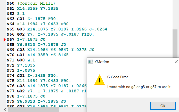

I am struggling to post a file from SolidCAM. When a G2 or G3 command are repeated, it doesnt include a G2, or G3 on the following line. KMotionCNC doesnt like this.
I am wondering why it can take a G00 or G01 in this way, but not a G02 or G03. Is there anything I can do in KMotion, or do I have to fix the post processor.

I word with no g2 or g3

Hi Scott,
The Interpreter needs an "X" or "Y" word or the G3 to be specified. Was that intending to be a full circle? Do you have an option to specify half circles?

I am not sure if it was intending full or half, when I manually type G03 or G02 in on the lines it seems to work without the an X or Y word. It is getting tedious manually editing the code.

Hi Scott,
Normally to do a motion at least one axis needs to be commanded to move. Otherwise something such as a blank line could be treated as a repeated move.
But I suppose a full circle is a special exception as i j k at least must be specified.
Here is a patched GCodeInterpreter.dll for V4.35f that should permit it. Copy to the C:\KMotion4.35f\Kmotion\release folder.
Please let us know if it works and if it causes any other issues.
