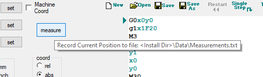

Are you suggesting to create a txt file and type the first three lines which include no of rows and columns and the second line defines the delta X and delta Y and the third line indicates the x and Y offset. then after saving the text file i need to define that file path in toolsetup screen - too/setup files - geo file.this is the image containing the file i have created for geotable.
this is image of window popuped after defining the path of the file i have created in geo file .
Re: understanding geo table
Posted: Tue Jun 14, 2022 5:52 pm
Partially correct. The txt file must be called measurements.txt in the Data folder. As indicated by the tool tip on the measure button.
And you do not want to specify the file in the Tool Setup screen until after it is valid and fully populated with data.
That is because the file is basically empty and invalid.
