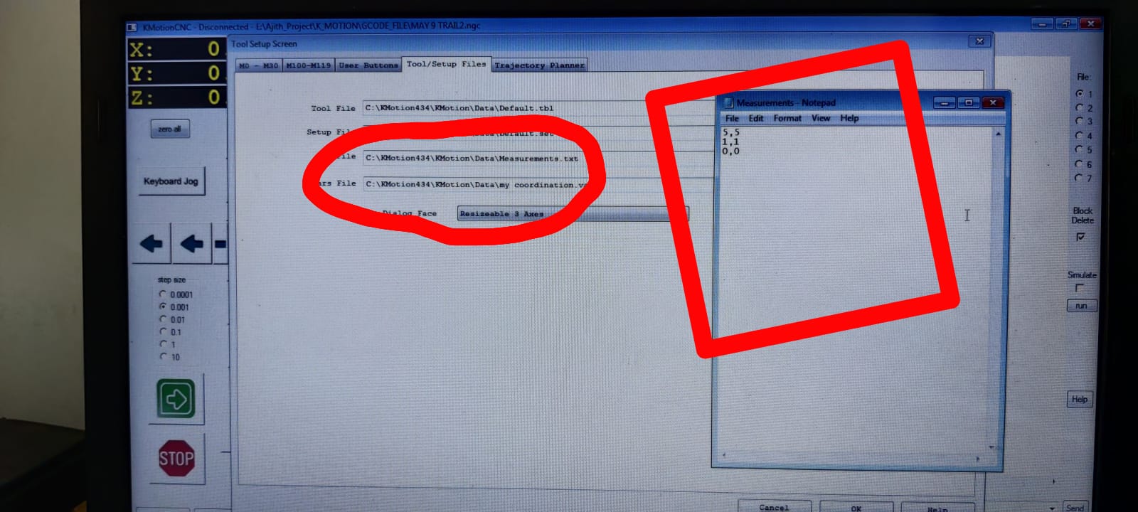

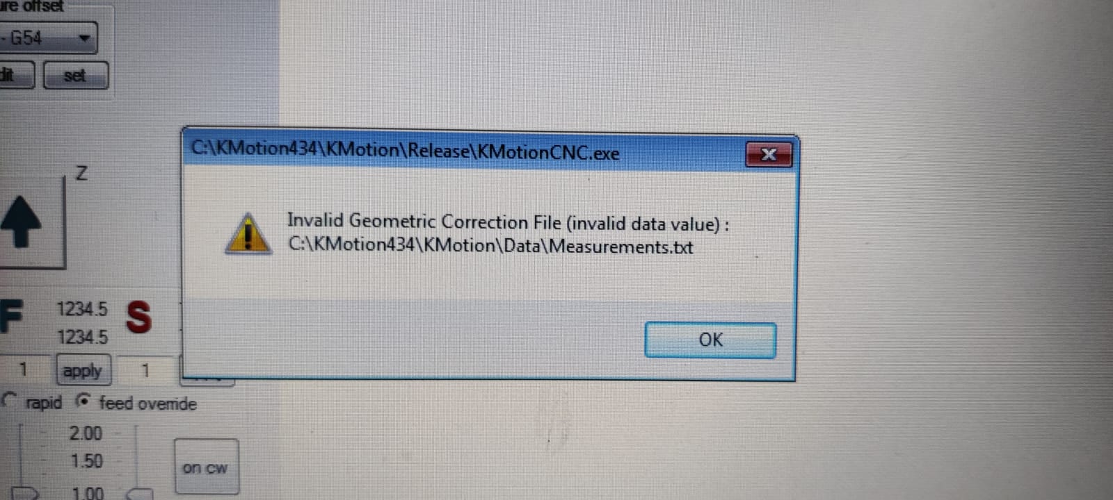

Today i have tried to create a geotable file as per your guidance and faced some following problem, These are file i had assigned . measurement.txt file used as geotable file. After assigning the file and press ok i got a popup window of above message.the file i used to assign for geotable file consists of three lines
5,5
1,1
0,0

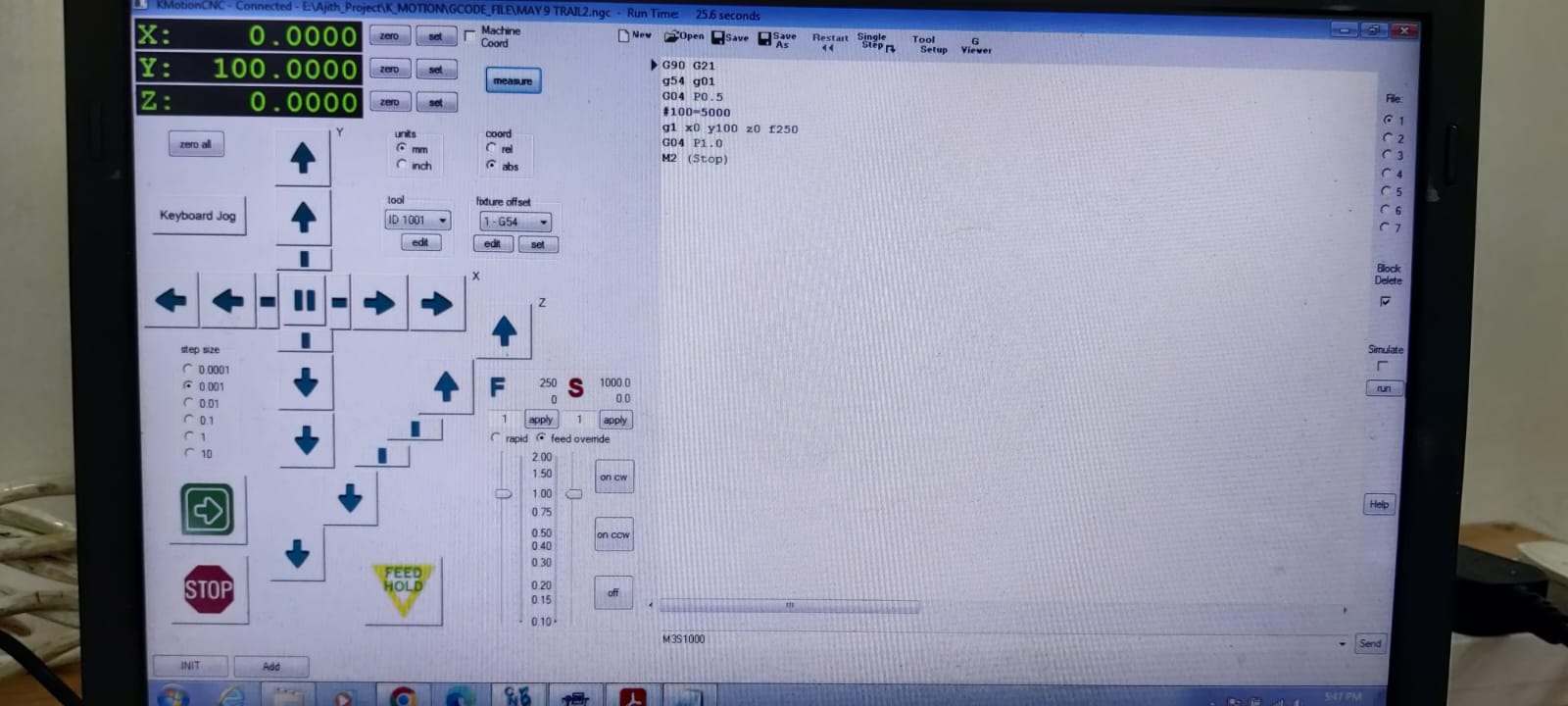

after ignoring the message, i jogged my y axis to 100 and pressed measure button After pressing the measure button, the values written in the geotable file and the jogged value is not same.

Respected sir,
Is there a way to change its units. and may I know the reason for the popup messsage
- Posts: 2933
Re: understanding geo table
Invalid Geo Correction File format. it should be 3 lines of header and then Rows x Cols lines of 5 values per line.

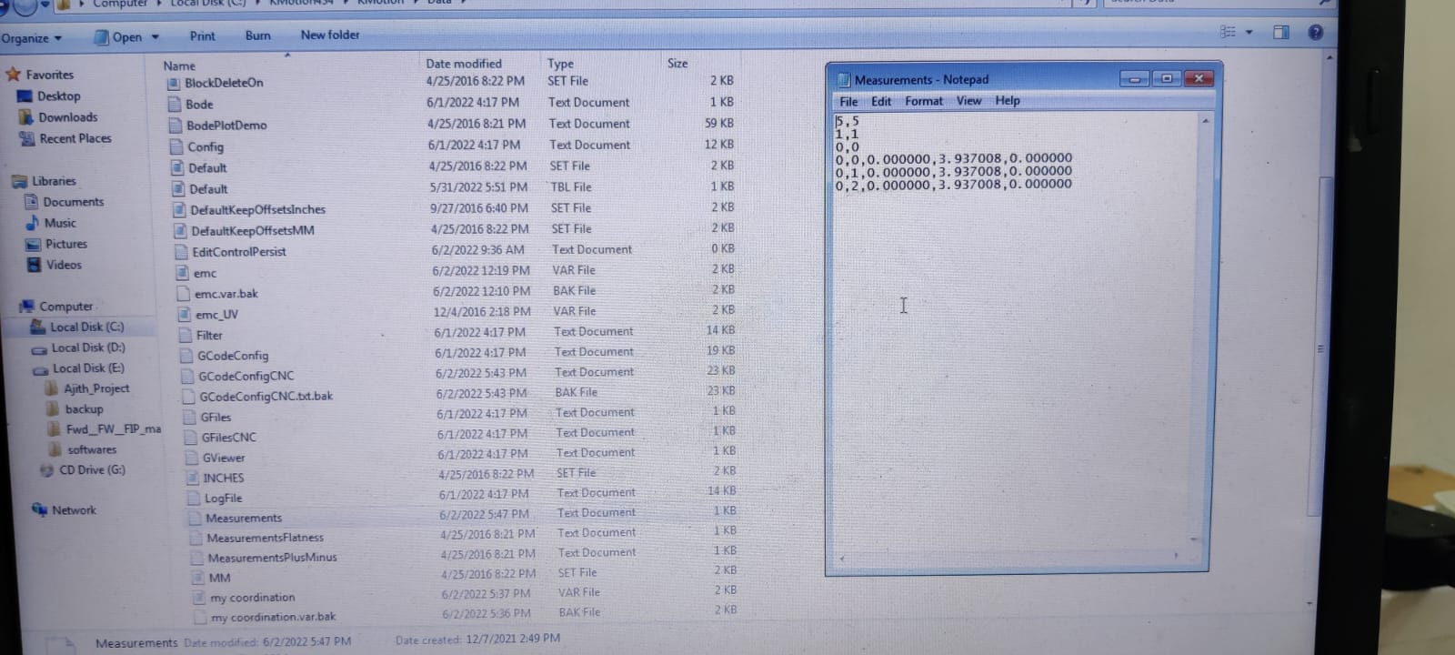

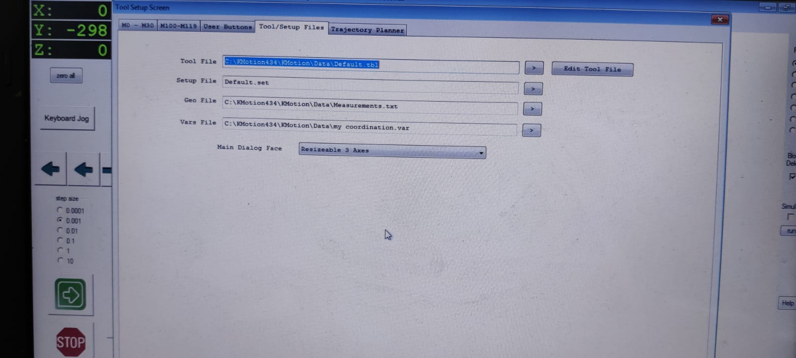

Respected Sir,

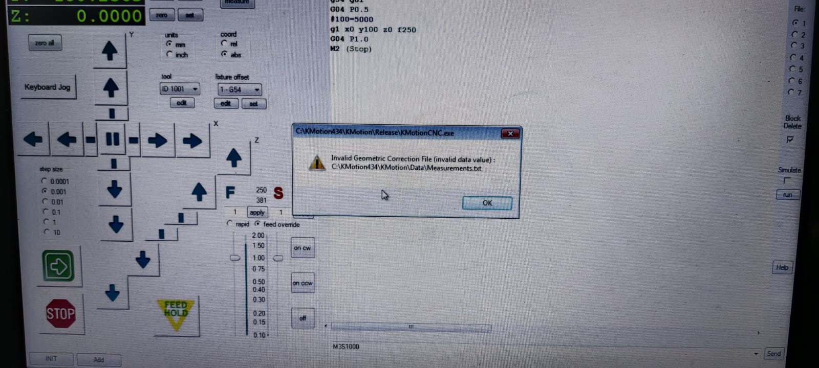

Are you suggesting to create a txt file and type the first three lines which include no of rows and columns and the second line defines the delta X and delta Y and the third line indicates the x and Y offset. then after saving the text file i need to define that file path in toolsetup screen - too/setup files - geo file.this is the image containing the file i have created for geotable. this is image of window popuped after defining the path of the file i have created in geo file .

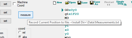

Partially correct. The txt file must be called measurements.txt in the Data folder. As indicated by the tool tip on the measure button.Are you suggesting to create a txt file and type the first three lines which include no of rows and columns and the second line defines the delta X and delta Y and the third line indicates the x and Y offset. then after saving the text file i need to define that file path in toolsetup screen - too/setup files - geo file.
And you do not want to specify the file in the Tool Setup screen until after it is valid and fully populated with data.
That is because the file is basically empty and invalid.this is image of window popuped after defining the path of the file i have created in geo file .
