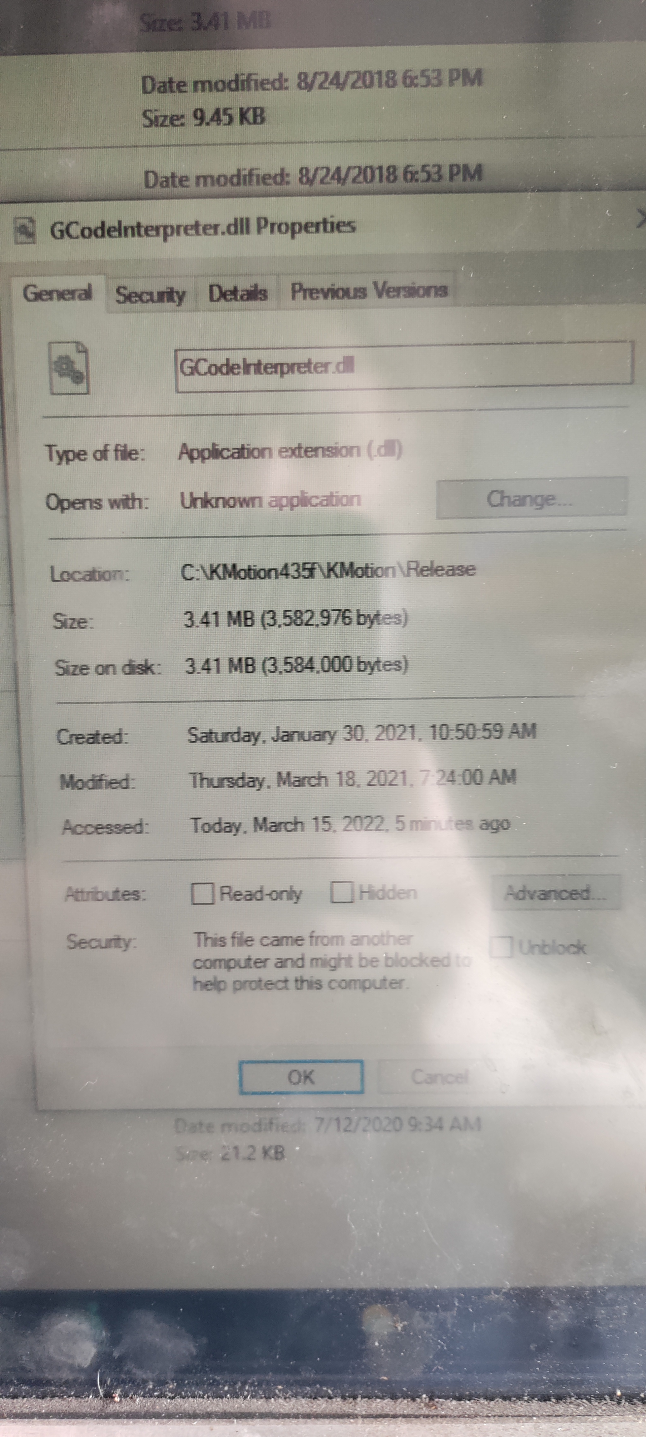

I commented out everything but WaitForNextTimeSlice(); in the forever loop. I get the same error in the same place. I *think* I might be using the trajectory planner from this link but I can not remember for sure:
http://dynomotion.com/Software/Patch/Im ... preter.dll
- Posts: 2916
Re: Error: Invalid buffer times in Trajectry Planner"
Please check the timestamp of the file.
