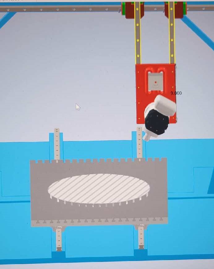

I was still getting too much bearing play through a weak design and the wiring situation gave me nightmares. Also took out a KFLOP board via a voltage spike! So I have decided to go to tilting B axis in the head and a C axis rotary table built into the table. This way I can have a continuous C axis and most to all of the cables can be statically placed. Will look like this.
My question is if there is a kinematics file out there already for something like this? Or could I modify the existing TableAGimbleB?.. As in change out the variable names/etc to make a new class for the C axis instead of A axis following these guidelines:
