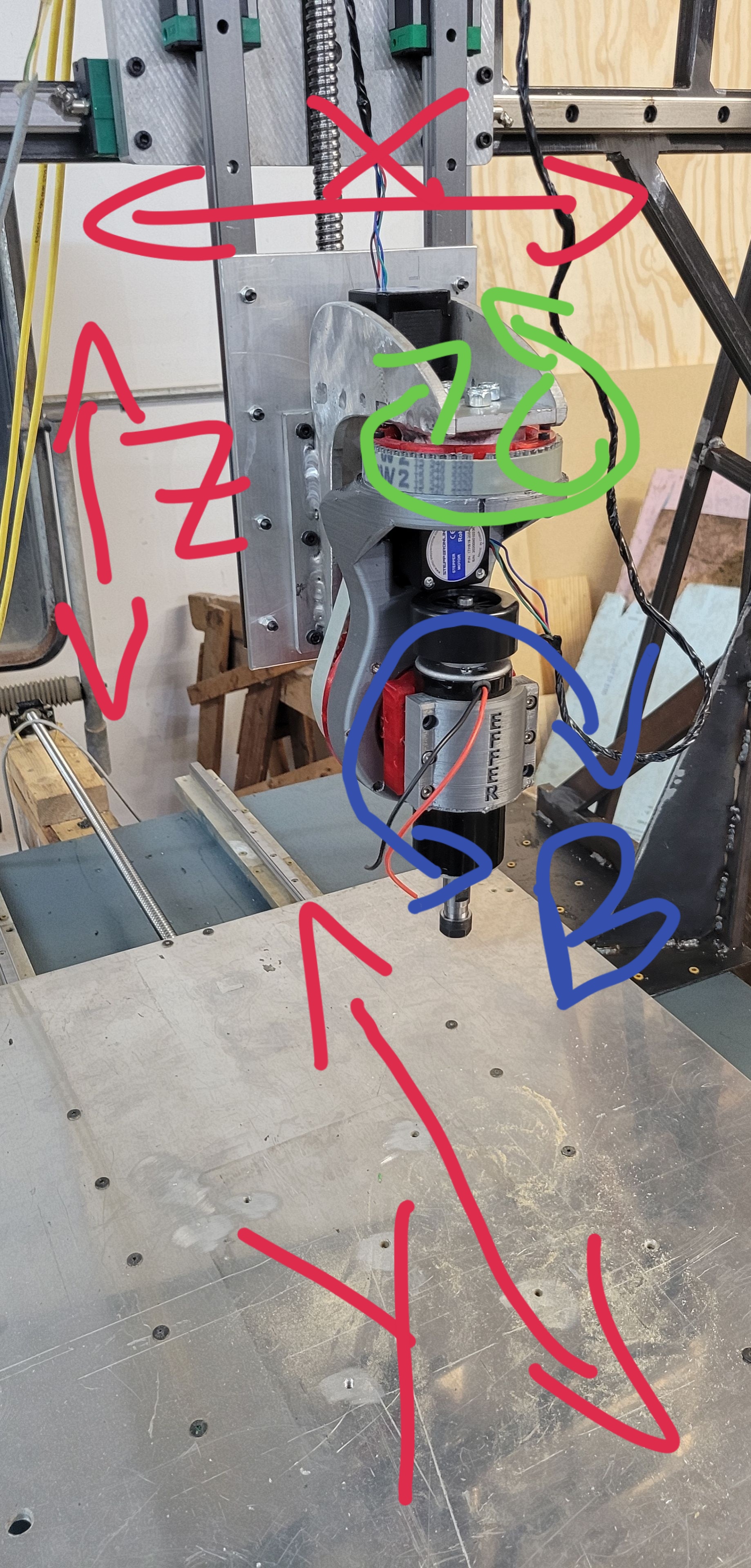

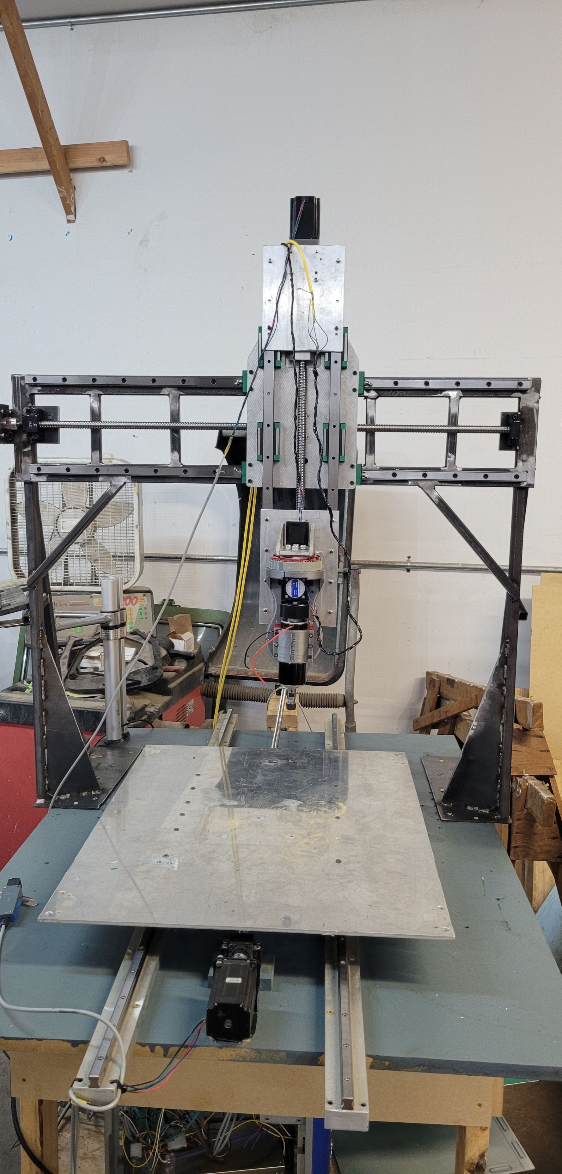

I have built and wired up my machine. Following the videos and forum, I have got the 5 axis up and running but only getting TCP when I have 5AxisGimbalAB in the kinematics file. When I type 5AxisGimbalCB save and reload the application it seems as though I am only getting "3rod" kinematics. I tried to rebuild the solution and reinstall Kmotion. All the correct headers in the programs seem to be there. But no matter what I do GimbalAB is the only thing that seems to load 5 axis kinematics with TCP. This is a preloaded kinematics class so I should not be having any trouble right? Or is there something I am missing? Running the latest stable 4.43 Kmotion download and Windows 10 on a Pro-book.
Here should be a picture of my setup confirming the need for the CB gimbal head. Thanks in advance for the help. Stoked to get back up and cutting and the opportunities Dynomotion brings to the table.

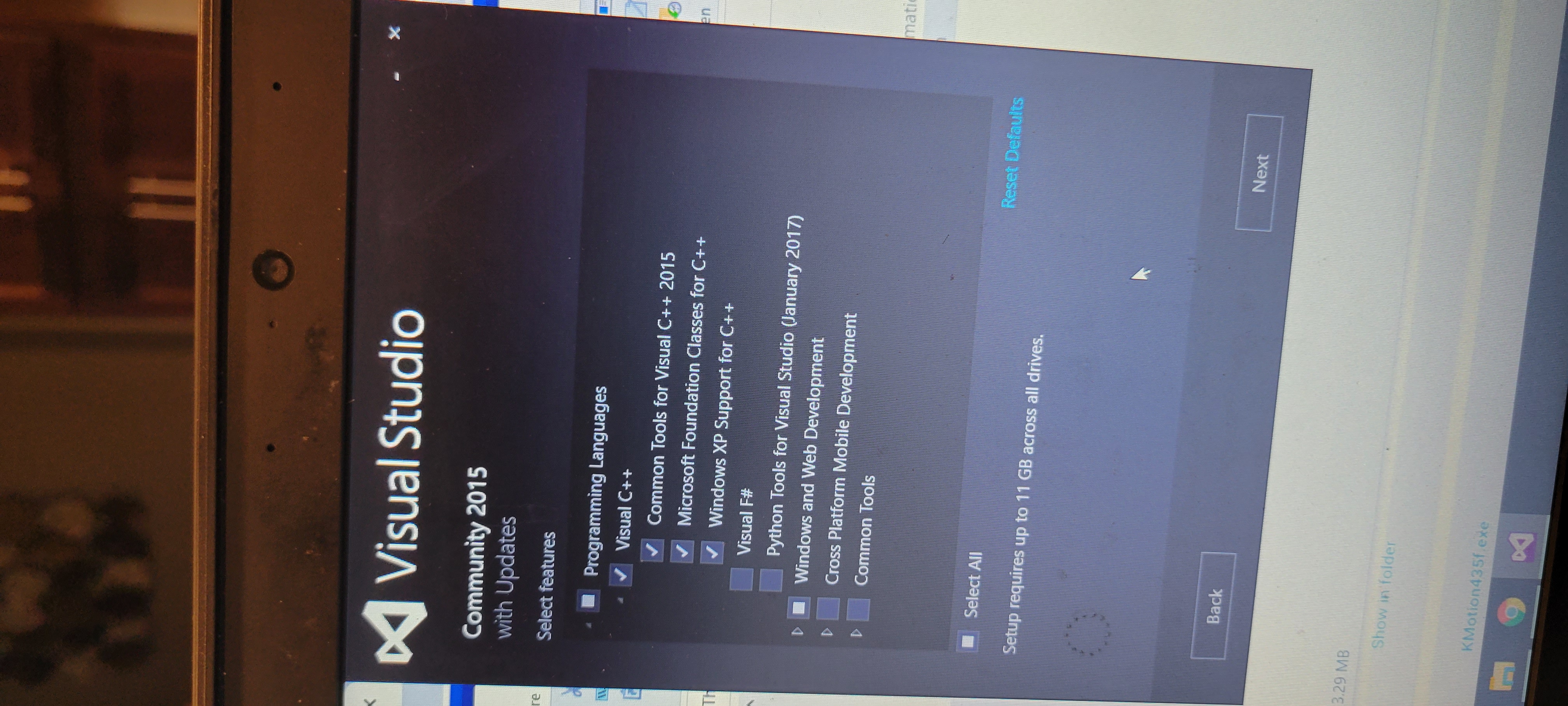

What errors do you get? Did you install the MFC option?I have been having some errors and not able to compile the buildalllibs but I think that might be my VS2015 setup. Says it cannot open alot of files but they are there.
Re: Gimbal CB

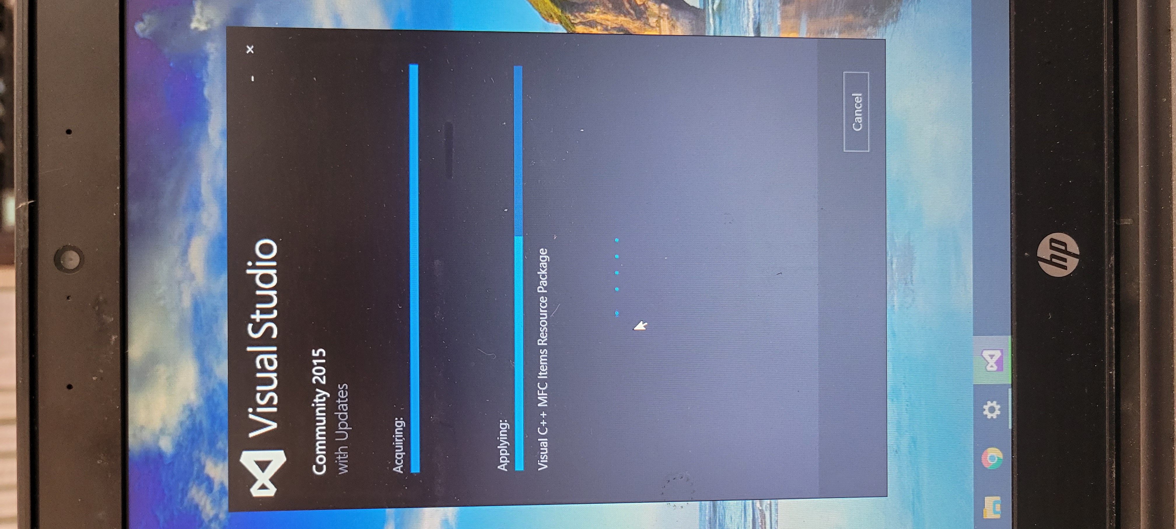

Doing a modify/repair since it redownloaded the latest redistritubles with the firmware update.
Read your comment as this popped up on the screen..so yes I would believe so!

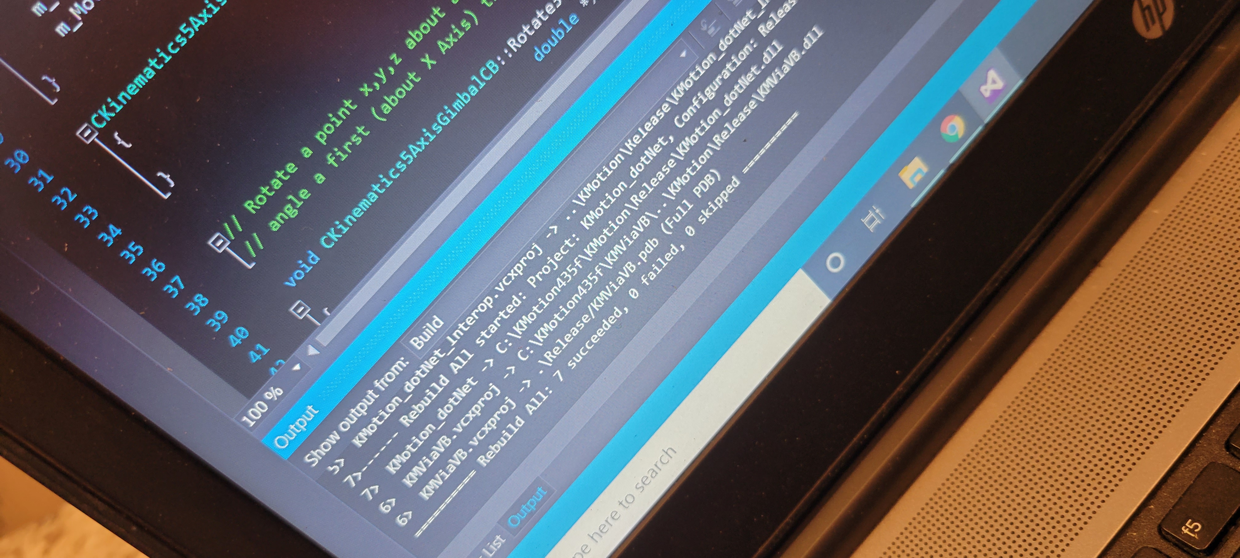

Re: Gimbal CB
Well after about my 3rd or 4th uninstall and reinstall I got it to compile! Successfully changed the value of one variable hehehe
Putting these here for the next guy.
