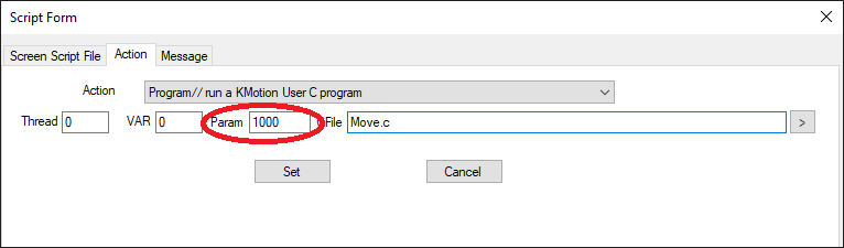

Re: Feedhold Backwards/Forwards speed
Posted: Sun Feb 11, 2024 6:31 pm
by TomKerekes
Hi Ibzan,
There isn't currently a way to read the text of a pushbutton. But if the text doesn't change then you might just code the value into the C Program for the button. Or you might pass the value to the C Program as the Actions Param.
Another option might be to use Edit Controls with buttons right next to them. In this case the C Program activated by the button could read the edit associated control. This would also allow the Operator to easily change the values.
