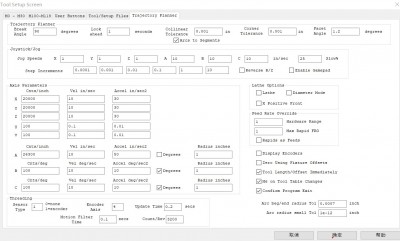

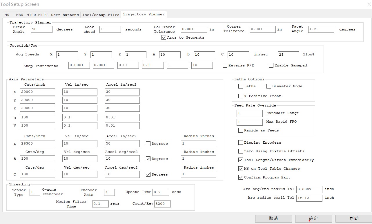

What are your KMotionCNC | Tool Setup | Trajectory Planner | Axis Parameters | Cnts/inch ? A zero will cause a division by zero when machine counts to inches.
Otherwise please post your Initialization C Program and your KMotionCNC Tool Setup settings.

Please post your Initialization C Program and your KMotionCNC Tool Setup settings.
This is the init program. I have commented the zero() part, but the error still appeared.

Attachment is the Tools setting. I have changed the Cnts/Inch value of all x,y,z axis from 40000 to 20000. Things are slightly better, for example the XAxis_CH->SoftLimitPos must be larger than 1100000 before when Cnts/inci is 40000, but now needs only > 700000 for ok. But inner essence is the same.
