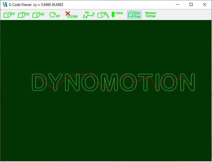

Here is an example scaling the X dimension by 0.5
Original
Scaled in X
