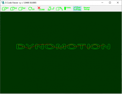

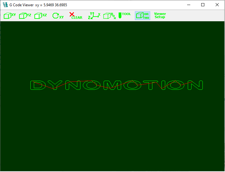

The Transform can scale the XY directions independently, but not if there are G3 Circles/Arcs because they would then become ellipses.

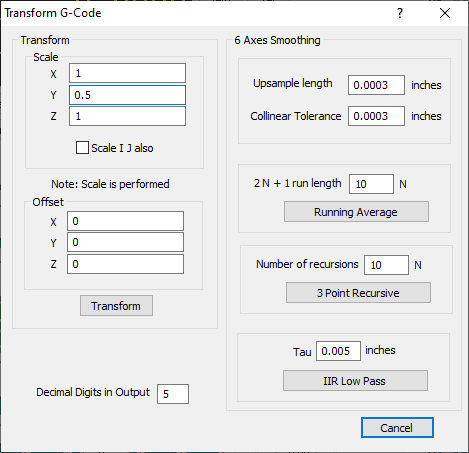

Here is an example scaling the X dimension by 0.5

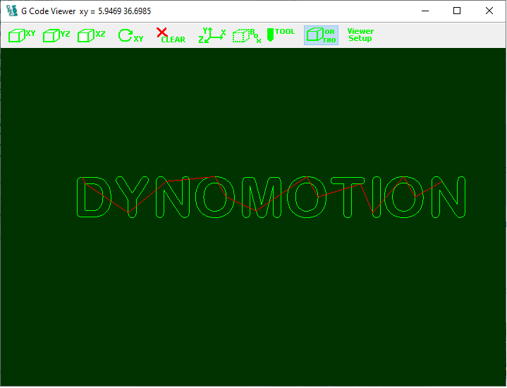

Original
Scaled in X
