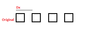

I am trying to make various repetitions of a structure defined in G-Code but displacing the origin of the structure a distance in each repetition. I’ll try to explain it with an example.
I have a square defined in GCode like this:
G0 X0 Y0
G1 X10 Y0
G1 X10 Y10
G1 X0 Y10
G1 X0 Y0
And I want to make another 3 squares, with the same measures, but displacing the X coordinates in each one of them.
example

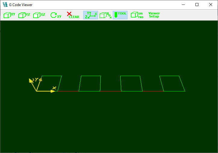

Hi Juanjo-Lasing,
Here is the syntax:
#1 = 20 (increment in X)
#2 = 0 (number of repetitions)
#3 = 4 (number of squares)
M98 P1 L[#3] (call subroutine #3 times)
M2 (stop)
O1   (Label 1)
G0 X[0+#1*#2] Y0
G1 X[10+#1*#2] Y0
G1 X[10+#1*#2] Y10
G1 X[0+#1*#2] Y10
G1 X[0+#1*#2] Y0
#2 = [#2 + 1] (Increment #2+1)
M99 (return)

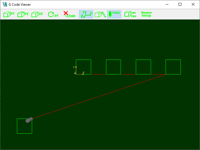

Another question, is it necessary to include the labels at the end of the file, after M2?
I tried to add new instructions after the label to add new movements but the simulator is unable to leave the loop.
Something like this:
#1 = 20.2 (increment in X)
#2 = 0 (number of repetitions in X)
#3 = 4 (number of squares in X)
M98 P1 L[#3]
O1   (Label 1)
G0 X[0+#1*#2] Y0
G1 X[10+#1*#2] Y0
G1 X[10+#1*#2] Y10
G1 X[0+#1*#2] Y10
G1 X[0+#1*#2] Y0
M99 (return)
G0 X-30 Y-30 (new square)
G1 X-40 Y-30
G1 X-40 Y-40
G1 X-30 Y-40
G1 X-30 Y-30
M2 (stop)
Posts: 2901
Re: Repeat GCode with Displacements
Post by TomKerekes » Wed Feb 05, 2020 6:38 pm
Hi Juanjo-Lasing,
That is the normal method. As your code is written after calling the subroutine is finished execution will "fall" into the subroutine code again and erroneously return without any subroutine call.
A subroutine call without any return can be used as an effective "jump". The subroutine call stack is circular to allow this.
