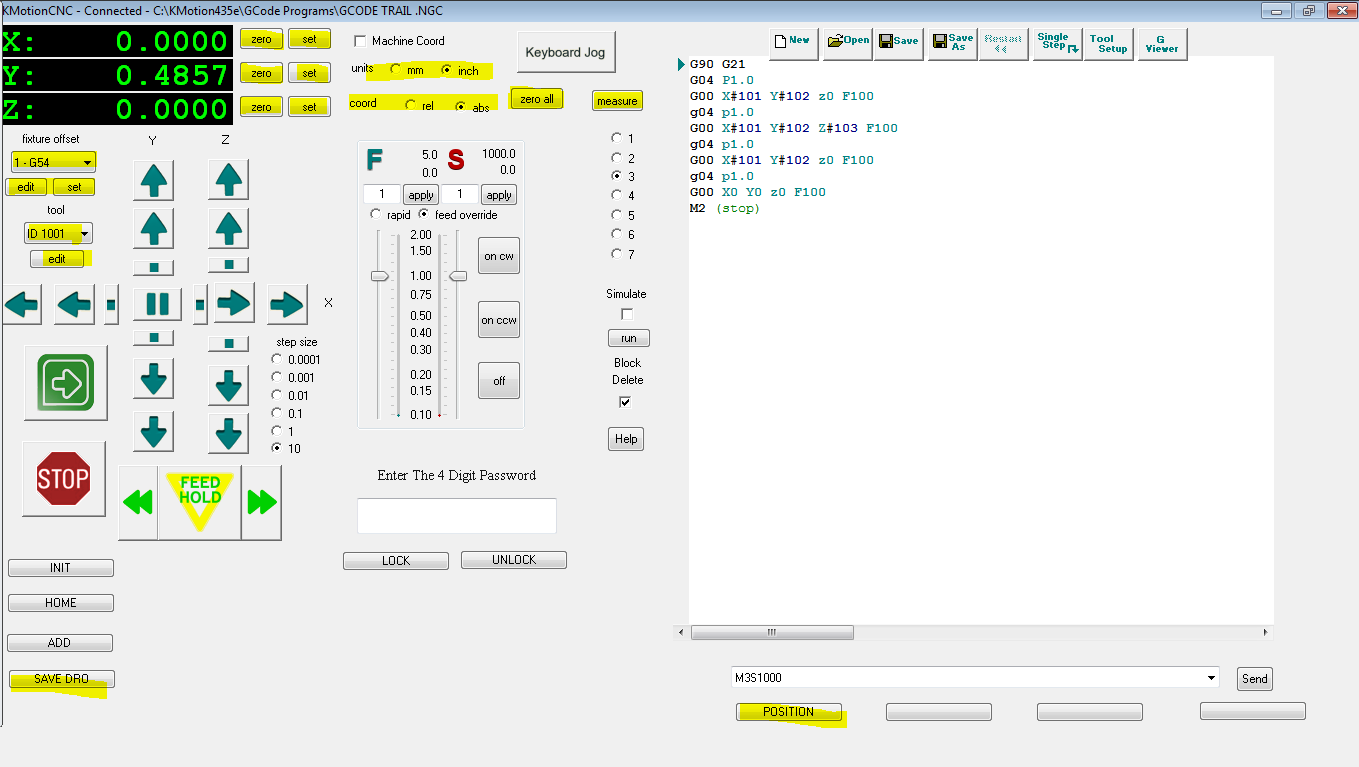

I also have another question that is whether i can inactivate the function of the following highlighted button in the below kmotion screen image?
I don't understand what you are asking.

I have two screens scripts assigned to two buttons which is used to navigate between them.one screen is the lock screen where i wants to set the gcode screen in "read only mode" and some buttons function need to be disabled.Another screen is unlock screen where i can be abled to read and write gcodes and all the button functions need to be enabled.but i tried to disable the buttons by changing its var to be 2 but it doesn't work. is there a way to disable the functions of button (without hiding the button) i have highlighted in the above screen and how it is done?

No there isn't a method to disable normal buttons other than hiding them. For custom buttons you might remove any action they perform. I suppose you could replace those buttons with dummy buttons or labels that don't do anything.

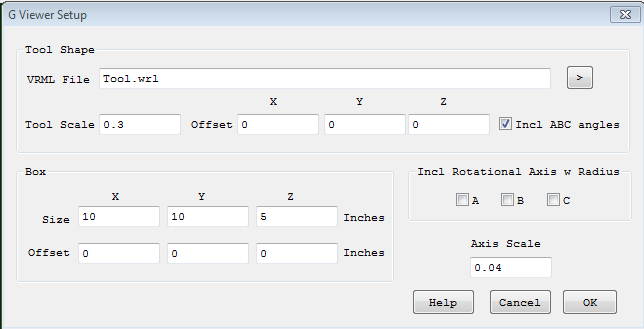

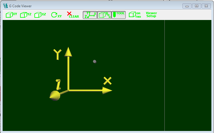

i execute gcode program of circle and opened my gviewer to verify its circumference but i cant get to view the path travelled by tool. The g-viewer just displays the movement of the tool without its path.
the below image is my viewer setup dialogue box

Posts: 2933
Re: saving the kmotion cnc jogged value to a permanent common variables
Post by TomKerekes » Thu Jul 21, 2022 4:40 pm
Hi Ajith,
When using a Custom Screen the GCode is plotted to the GCode Viewer on the main screen.
