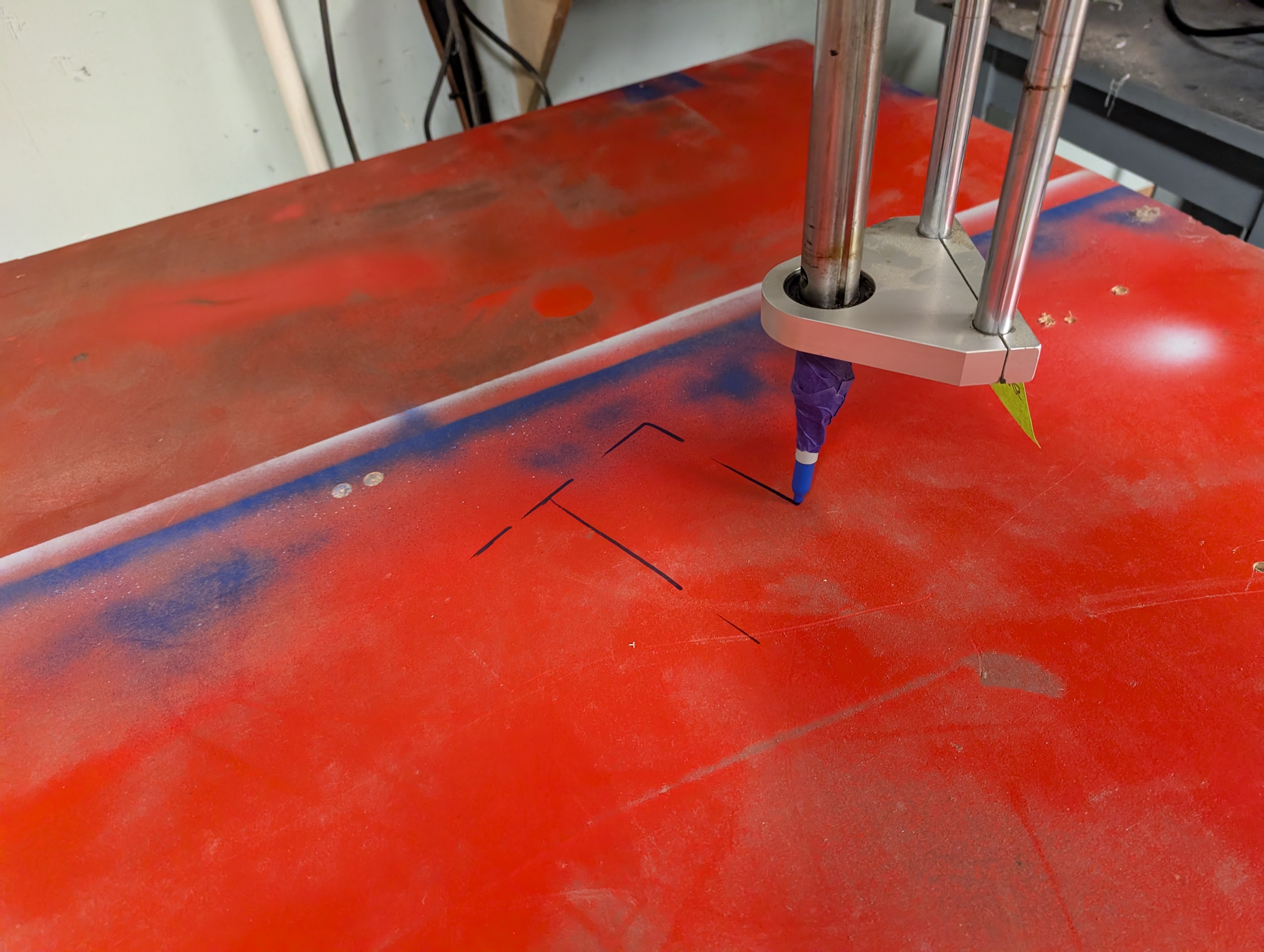

Setting the values in the trajectory planner worked. I can now make some xyz motion from KmotionCNC and the results seem reasonable. The image isn't much, but it shows a sharpie drawing straight lines just by jogging x and y and changing the height by jogging z.
But I'm still missing something, some jogs cause an oscillation that I can't quite explain. The youtube video shows the pen moving in x back towards base, then in y+. Shortly after it starts moving in y it starts to oscillate while I'm still holding the y jog button. When the arms are father out, so a smaller angle between the arms, the y direction works fine.

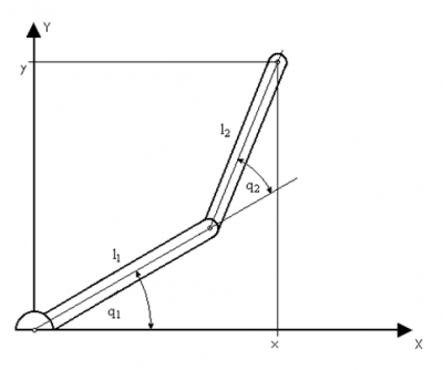

I think the axes should homed in a way such that the primary axis should point in the X direction when at 0 and the second axis in line with the primary axis when at 0 like the diagram below as described in the posts above. But you haven't described your geometry to us.

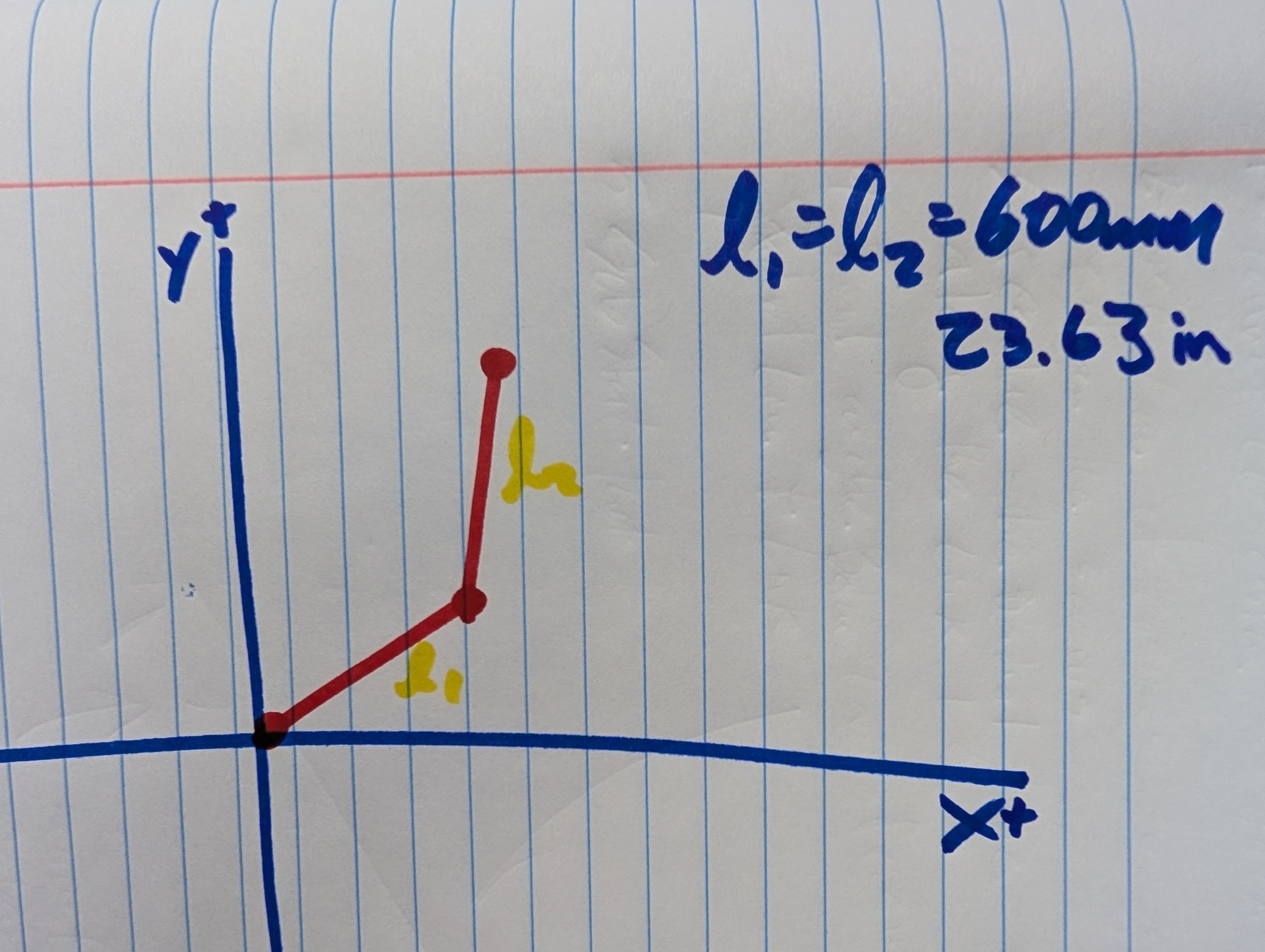

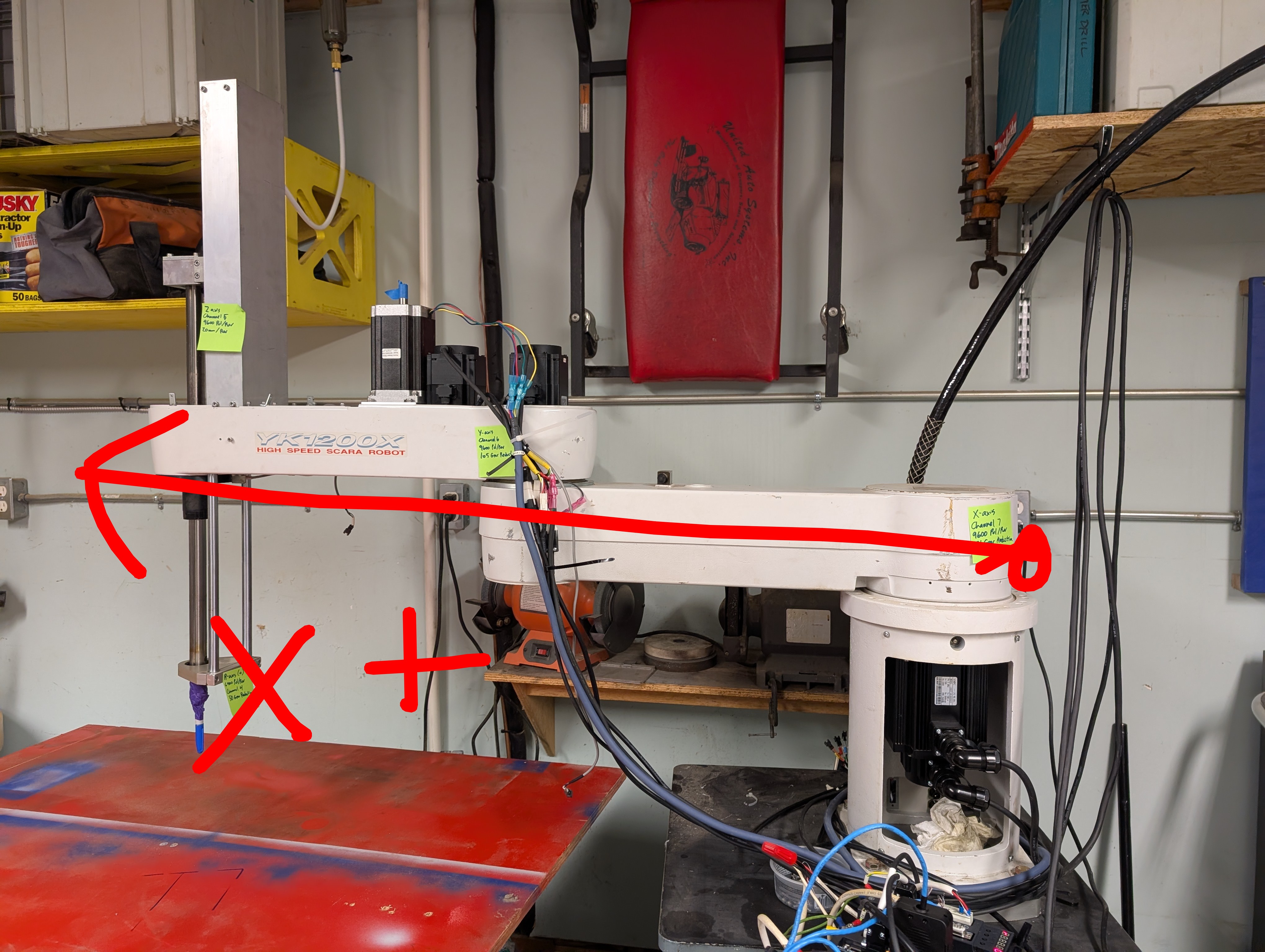

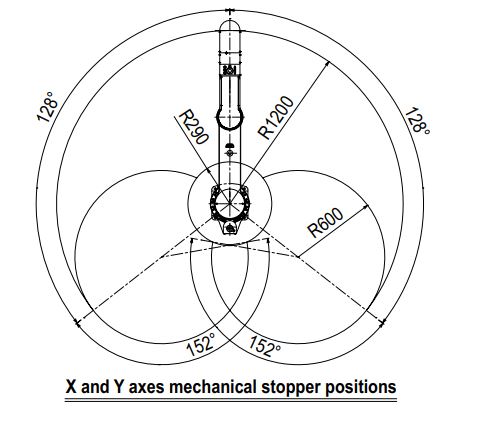

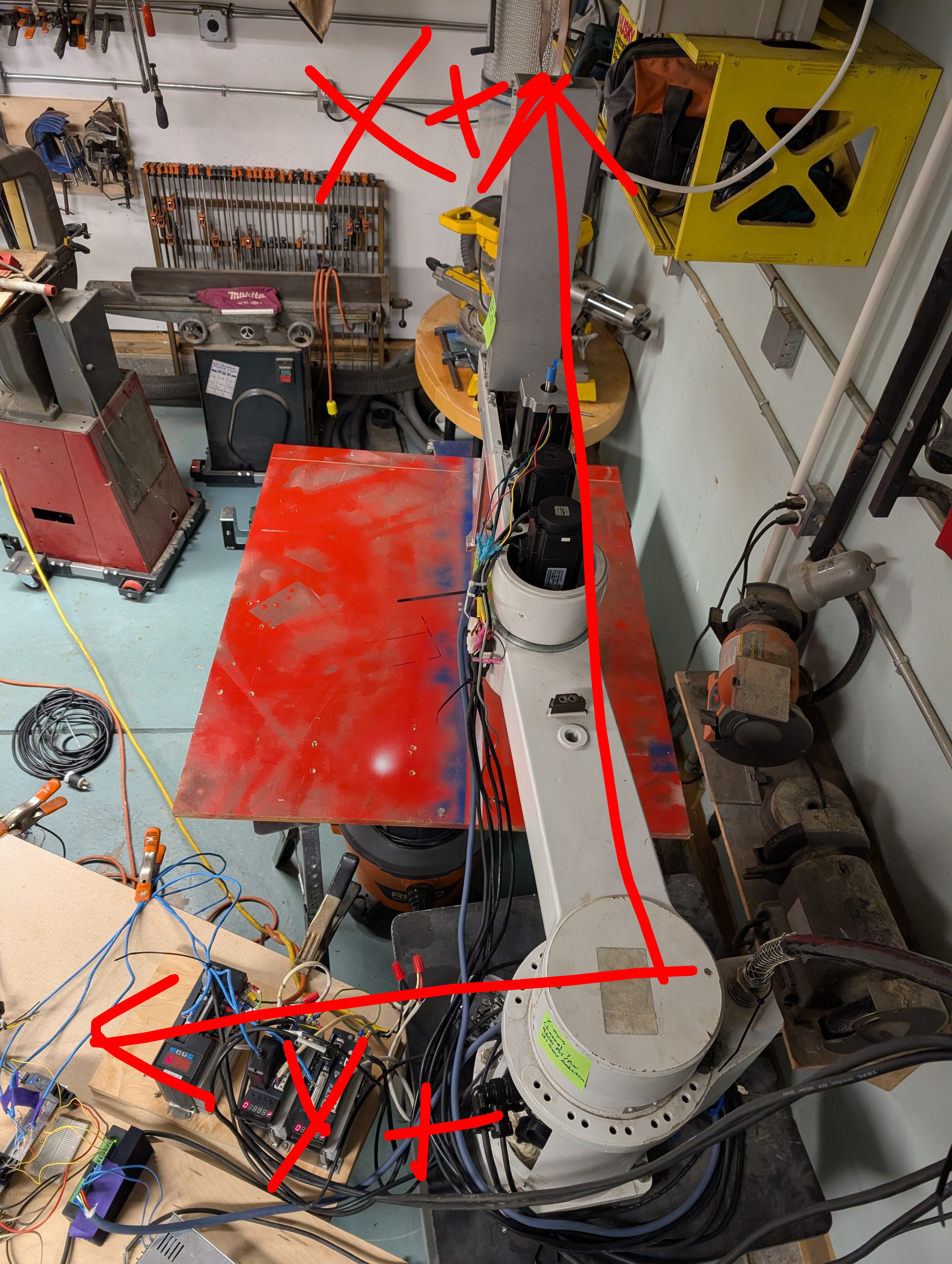

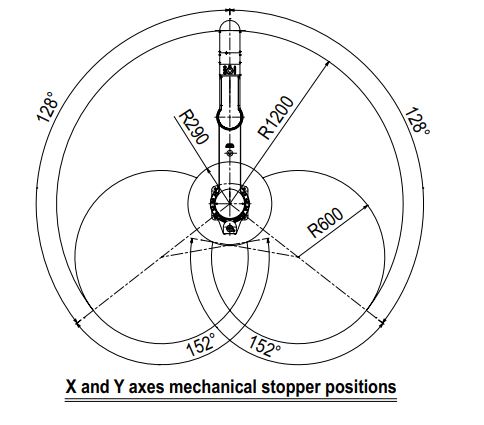

Sorry for not describing the geometry better. It is a yamaha scara robot. I have attached more details but It essentially the same as in your diagram. Both arms are the same length, 23.63 in.
After reading your reply I first moved the arms inline and along something close to an x axis. Then I set the postion of the end (47,0). I tried a simple gcode move, which went in a completely different direction than I expected. It also went way too fast to be safe. So the next thing I did was slow the max velocities and accelerations down in the step response window, and then updated my init file.
Next I tried the jog step. I started with z (channel5) which is just the vertical position of the end effector. It seems spot on.
Then I tried x and y jog steps at .01 inch. The motion is very inconsistent, sometime it really jerks hard other times it is slow and smooth, sometimes it looks like it is generally going in the right direction other times, not so much.

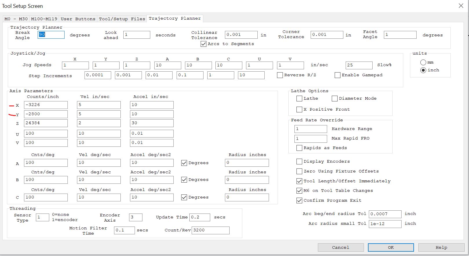

One thing I realized is my shoulder joint is turning the reverse from what I think should be the positive direction, for coordinates as drawn. So for example, a moveRel7=5000 from the console moves in what would be the clockwise direction, looking down on the robot, or towards the x axis. I think I just need to flip the direction in the channel setup? I'm guessing it is straight forward, but I'm missing it. I did try setting the count/deg in the trajectory planner to negative but I don't think that was right. And, oddly, now that I changed x and y ( I mistakenly changed y) I can't seem to set them back? I tried removing the minus, but they seem to persist after choosing "OK" and also after a restart.
On top of all this, I did not do anything with the "jerk" in the step response screen, I left the default. Not sure important this for what is, if I' sayin git right, effectively an open loop system, form Kmotion's perspective?
Thanks for the help,
Dana
PS I'm also attaching my kinematics file and my init file

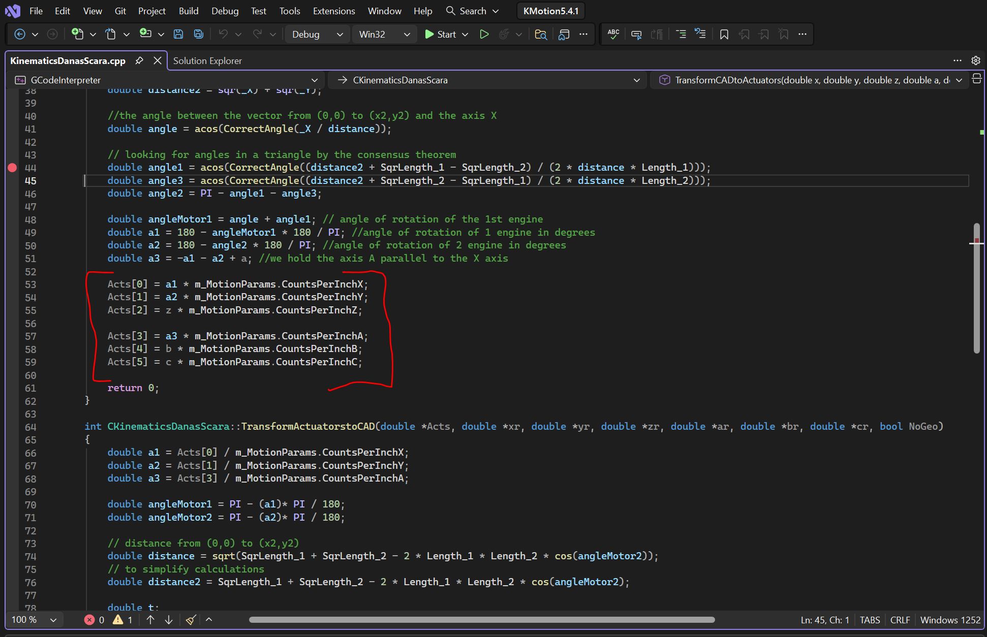

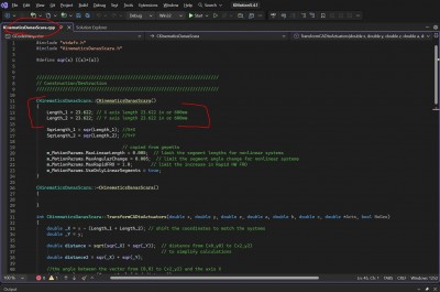

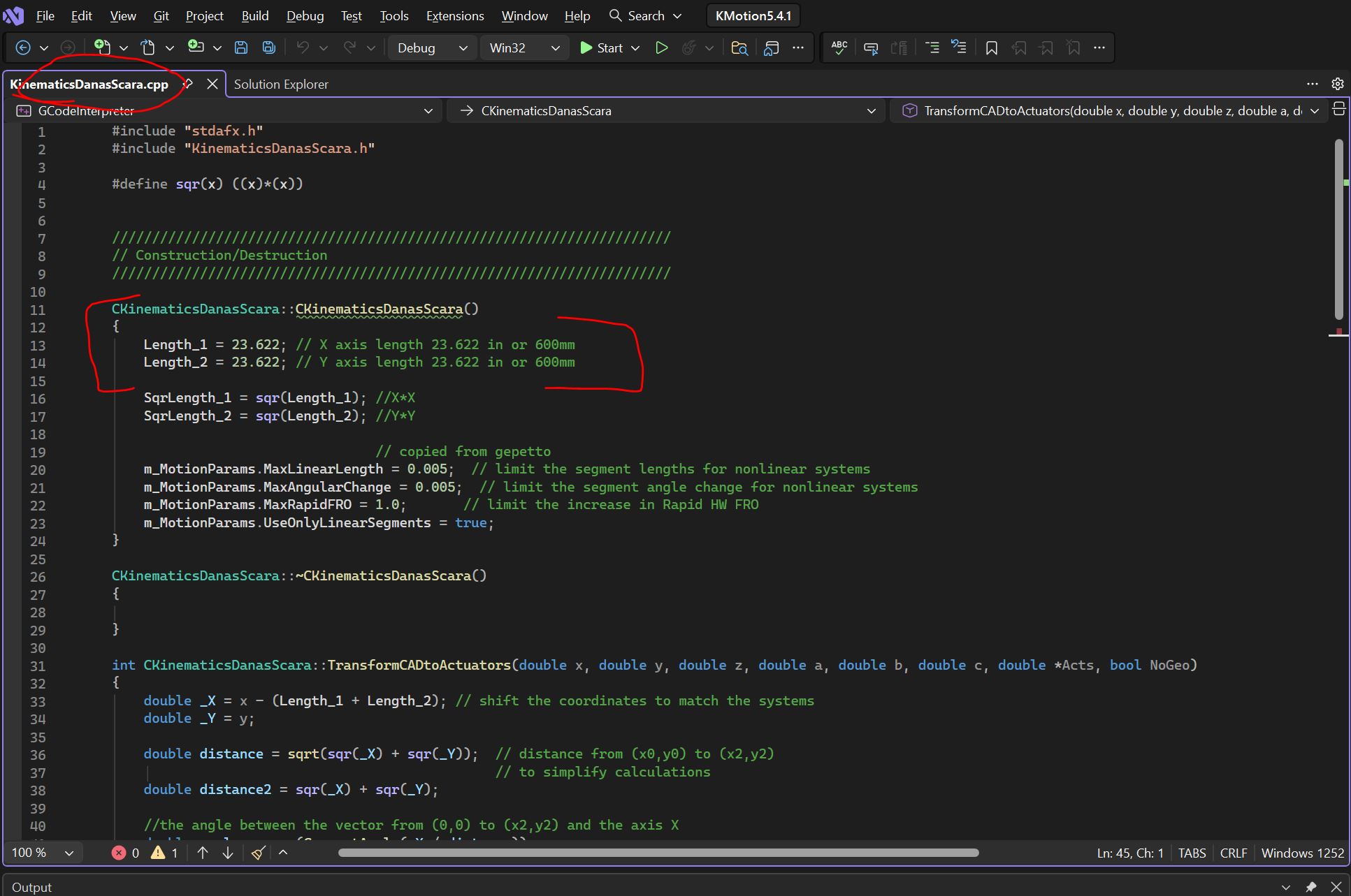

Tom, I was going to clarify that I was mostly blindly using the scara kinematics files included (KMotion5.4.1\GCodeInterpreter\KinematicsScara.cpp) with kmotion, with the one change of making the arm lengths match my machine. I opened it to take a closer look, and now I think I am maybe treating 0,0 wrong. I think this line offsets the machine base to right (x pos) of 0,0 by the length of the arms.
So more like the image here - https://www.dynomotion.com/wiki/index.p ... s#Overview
And not like my drawing
I still think I have something wrong with my shoulder joint rotation direction, and maybe someting off with acceleration and jerk? But let me also try to remove the offset from the kinematics file, to move the machine base back to 0,0
Thanks again, sorry for the confusion,
