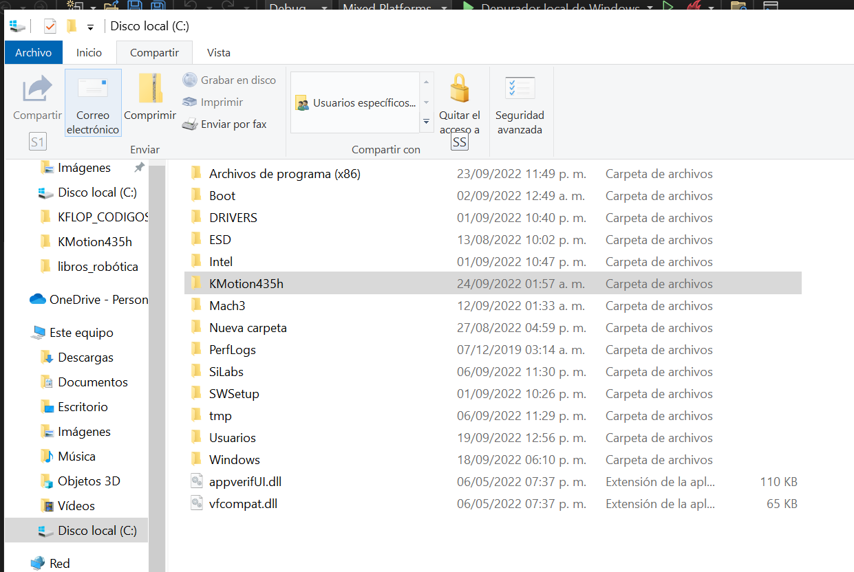

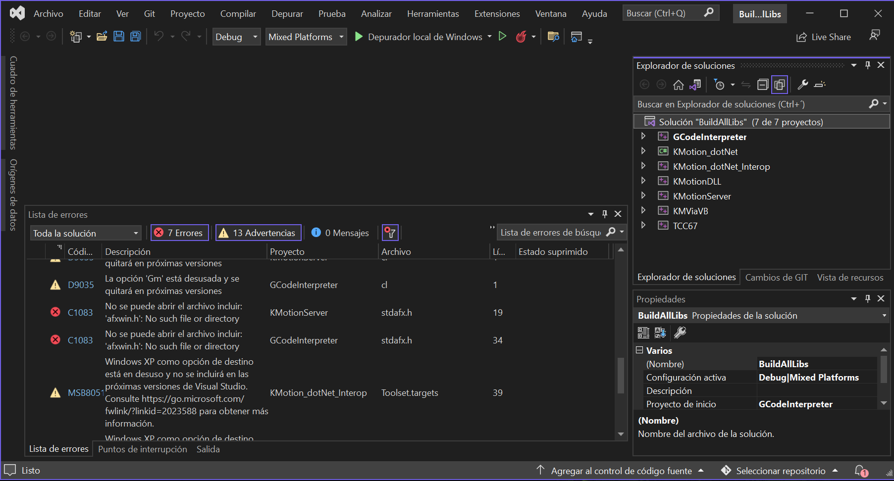

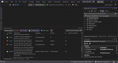

I already downloaded the KMotion 435h trial version, but I can no longer compile it in VS2019 or VS2022, I tried to search for the 2015 version but I couldn't download it anywhere. When I compile it, it sends me these errors. (Attached photos).
I don't know if I'm compiling it correctly. :roll: :?:
An apology if my doubts are very basic, and thank you very much for taking the time to answer.

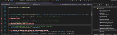

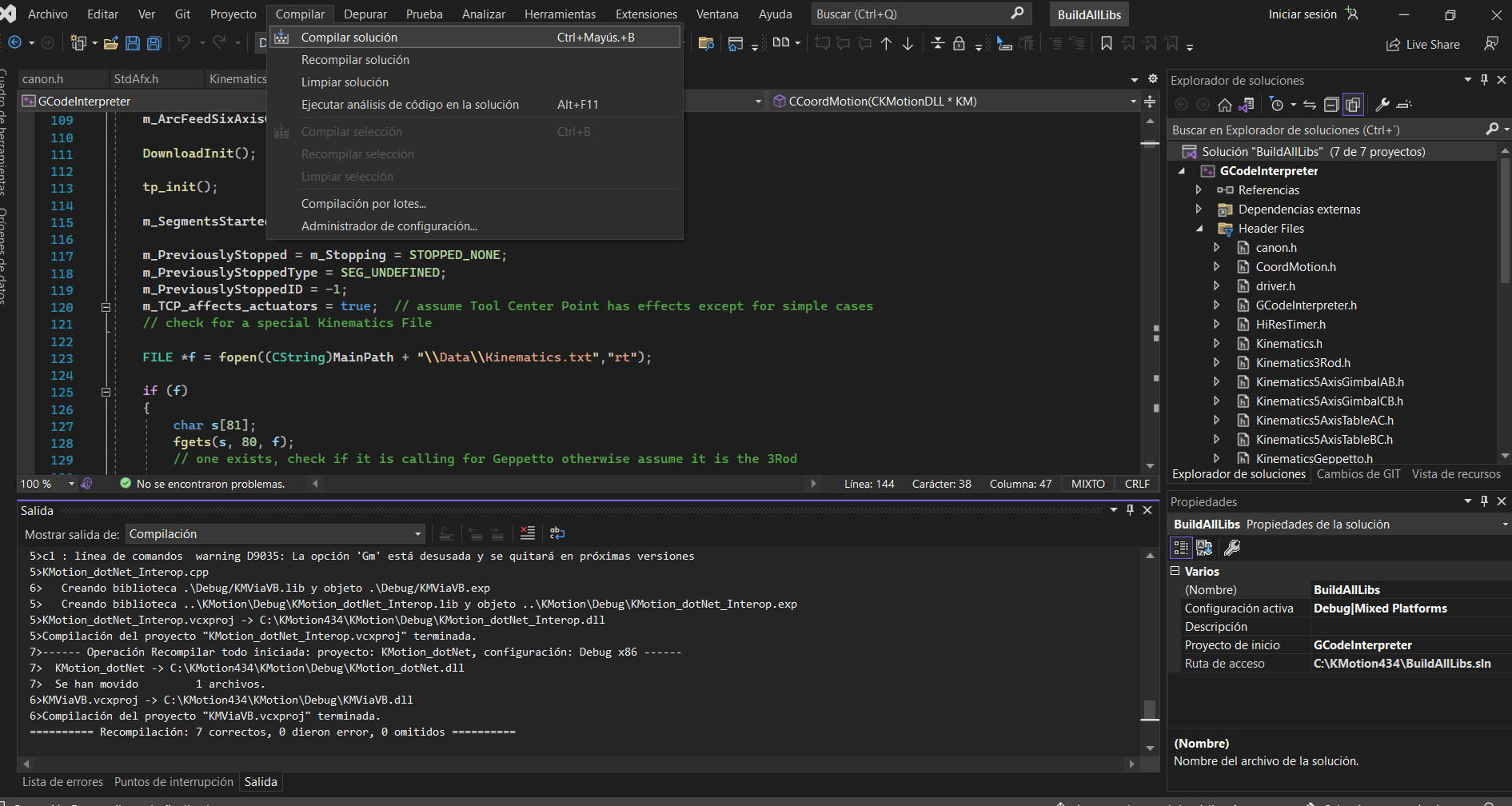

I already solved the compilation, with the steps that you indicate and I was able to use a different kinematics, but it does strange things to me.
Now I'm trying to debug the code to see what I'm doing wrong. :( :( :cry: :cry:

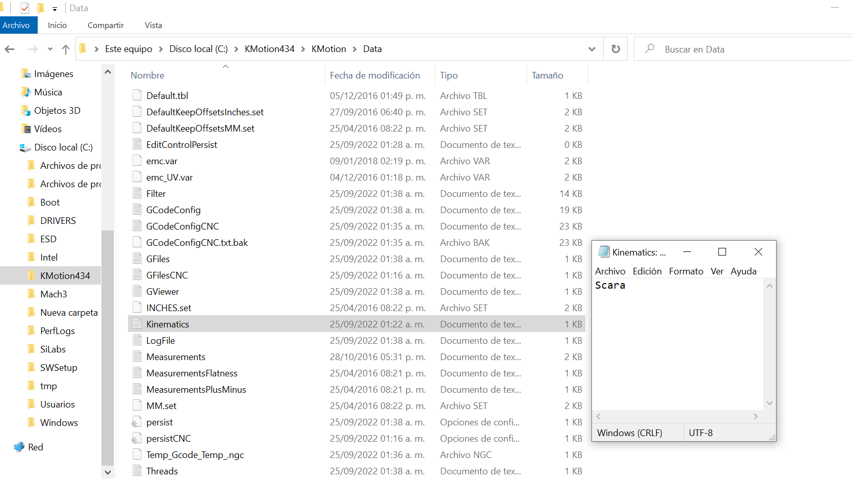

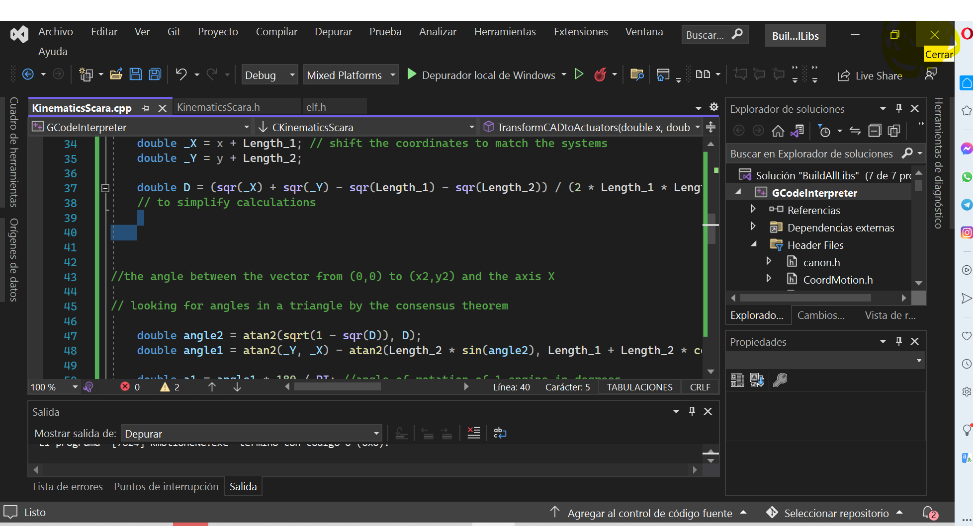

Do you know how to set breakpoints and debug in VS? If so, I'd set a breakpoint in your equations and see if they are actually being executed.

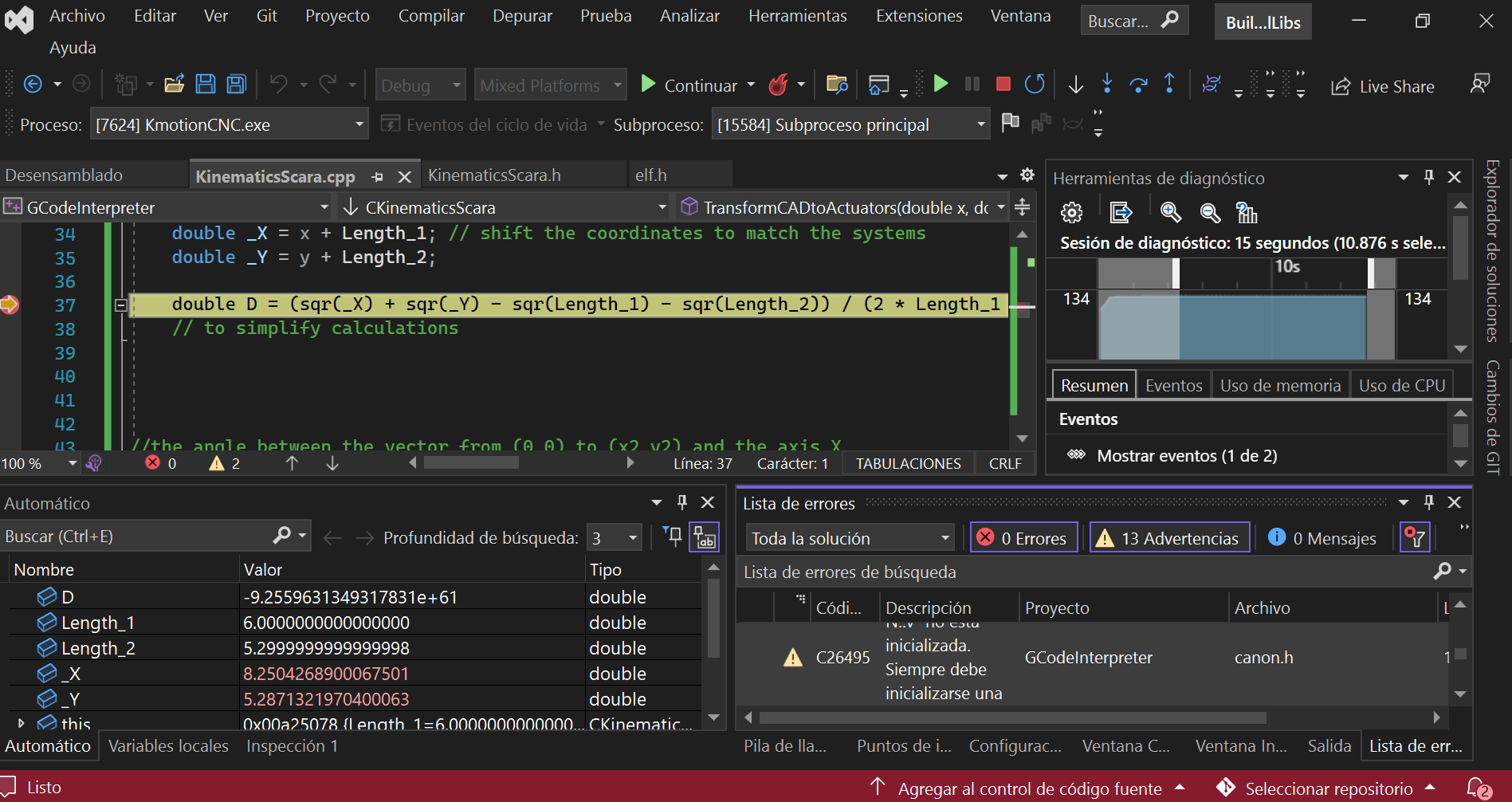

The truth is I don't know much about programming, I've used debugging in simple applications but not in these cases.
Steps 1 and 2 of the instructions that I mention cause me confusion. Where do I find KmotionCNC? It mentions that it has to be created, with what extension it has to be generated and how I link it with the new kinematics class, in order to do the debugging. :shock: :shock: :? :?
Very thankful

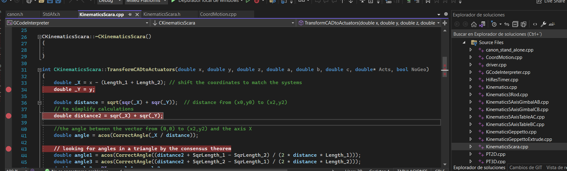

Re: Softlimits and scara kinematics
Post by TomKerekes » Sun Sep 25, 2022 6:33 pm
Hi Ibzan,

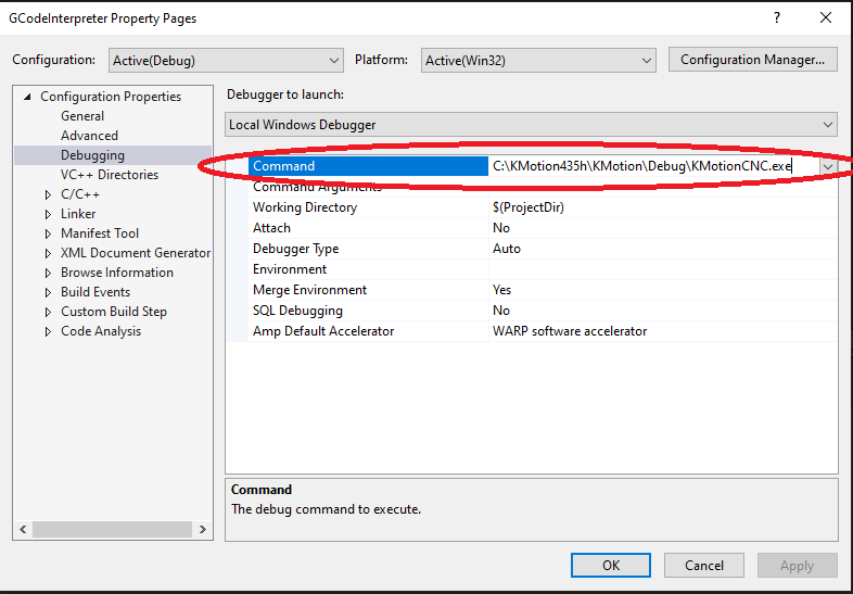

Your code is part of the GCodeInterpeter Library. You can tell Visual Studio to run KMotionCNC which uses this Library by setting this:
Then Debug | Start new instance GCodeInterpreter.

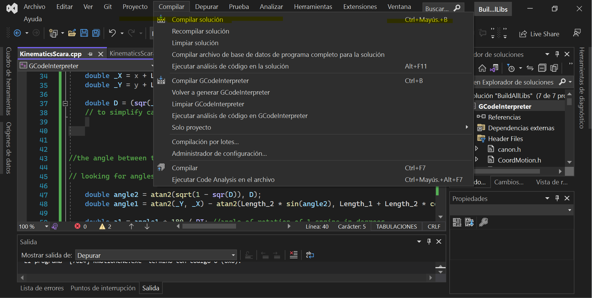

I have already reviewed my equations, and I already have them correct, but now a new problem, arose with the debugger the system works fine, however I compile it again and I want to openthe normal and program it doesn't work correctly.
Am I skipping an important step? :?: :?: :?: :?: :?:
DEBUG
COMPILE

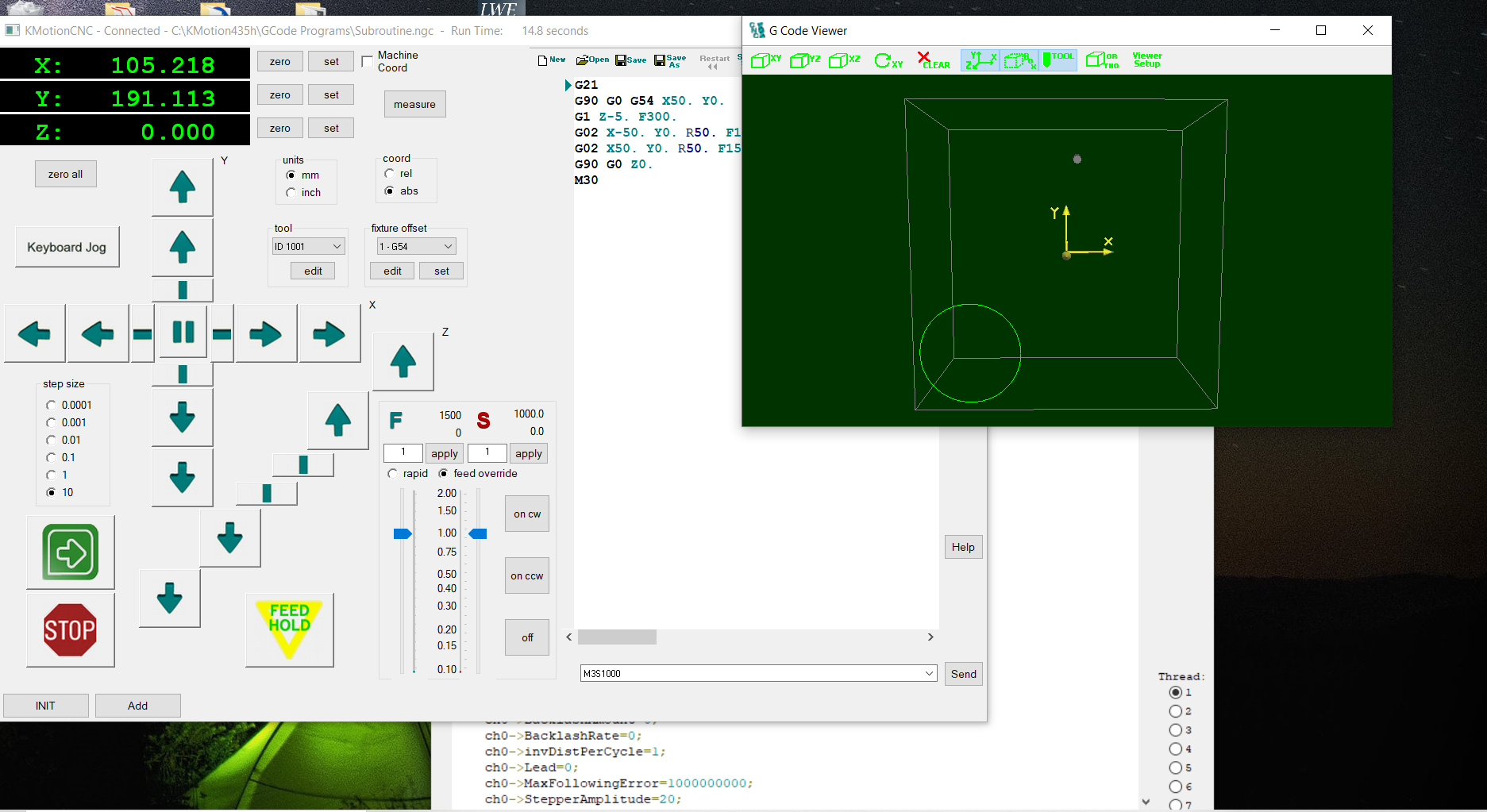

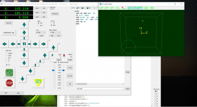

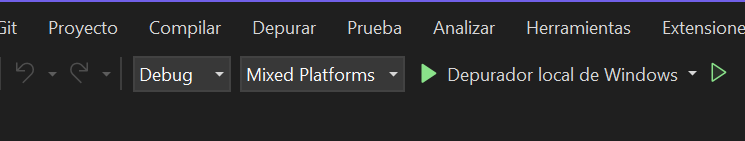

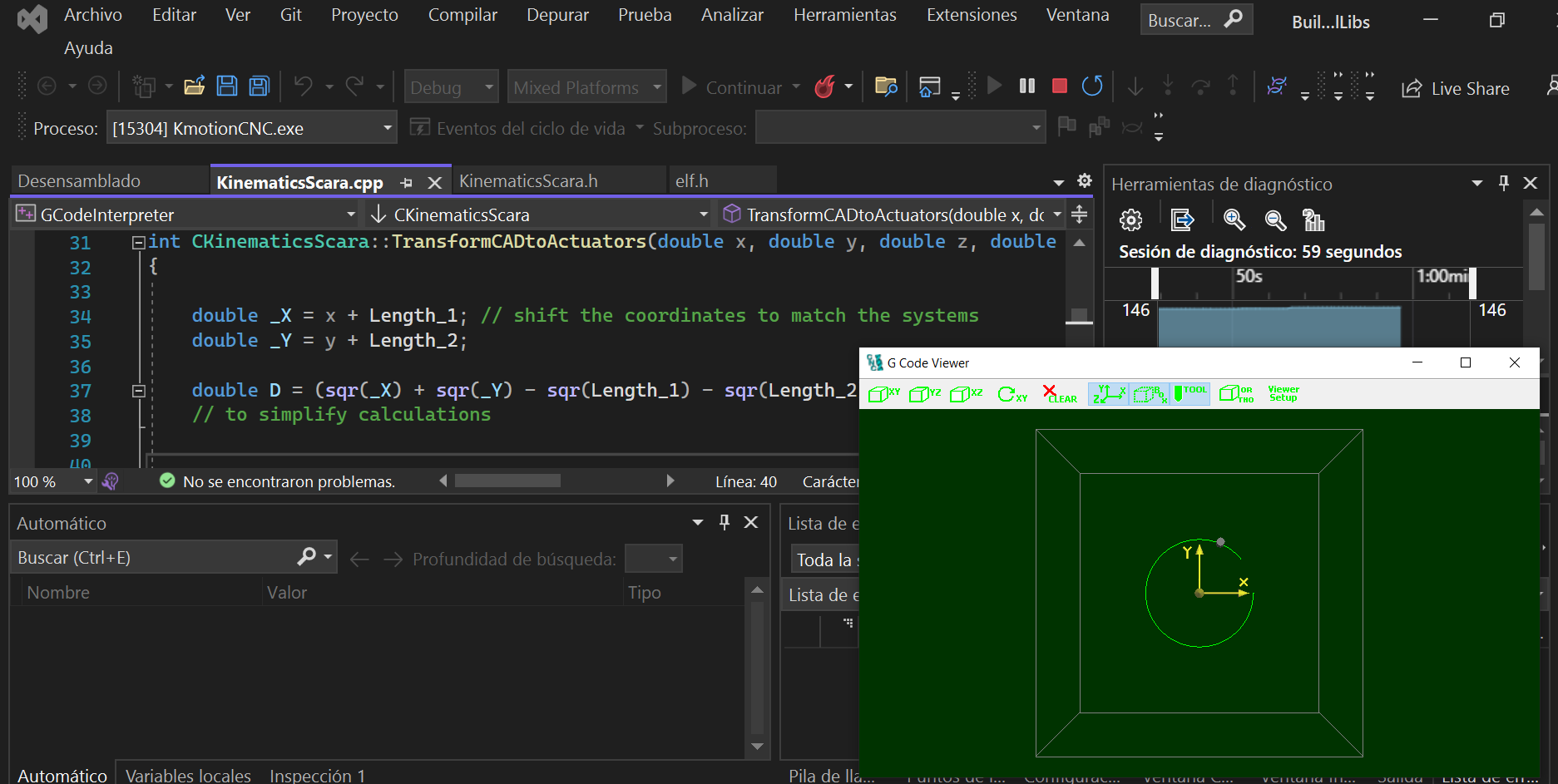

From Visual Studio, when i run it from visual studio KMotionCNC runs fine.For example, I am generating a circle in G code, if I execute it the Planar Robot moves properly and in the G code viewer the figure is correct (figure 1).
If I run it normally, that is to say from the desktop, the robot moves incorrectly and the figure it shows me in G code is incorrect (figure 2 y 3).
After debugging it, I give it complilar. I don't know if I'm missing an important step to update my code?
Thanks again for the help, I hope you understand my doubt or my problem.
Post by TomKerekes » Thu Sep 29, 2022 6:28 pm
Visual Studio has various build configurations. Basically Debug and Release. Debug is less optimized and easier to Debug. Release is more optimized but difficult to debug. Debug code is placed in the \KMotion\Debug folder. Release code is placed in the \KMotion\Release folder.
Your desktop icon probably points to the Release folder. If so rebuild in the Release Configuration to recompile the Release code.
