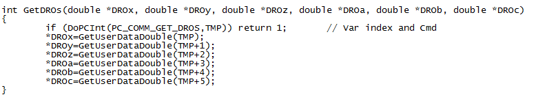

After gone through the "SetFixtureZ.c" I had doubts in the following program lines,
can you explain what is
[PC_COMM_PERSIST+2]
and
DoPCInt(PC_COMM_GET_VARS,varoff);
what is the purpose of variable n(no of elements)?
can you explain this command line
((int*)(&d))[1] = persist.UserData[i*2+1];
what is this line mean
if (DoPCInt(PC_COMM_GET_DROS,TMP)) return 1;

Hi Ajith,
Minor thing: I assume you mean "questions". In English the word "doubt" is used more when you distrust or don't have confidence in something. What is the word for question in your language?
I think you would be better focusing on what the functions do rather than how they do it. You only need to know what they do to use them. But sometimes it helps to know how they do things.
[PC_COMM_PERSIST+2]
There is an array of 200 persist variables in KFLOP that both the PC and KFLOP can read and write called persist.UserData. These are 32-bit integer variables. A few of these are used to send commands and parameters to KMotionCNC. PC_COMM_PERSIST is the first one used. PC_COMM_PERSIST+1 is the 2nd. PC_COMM_PERSIST+2 is the 3rd.
This puts the varoff (where KMotionCNC should put the results) into [PC_COMM_PERSIST+1] and places the Command Code PC_COMM_GET_VARS into [PC_COMM_PERSIST] which issues the command that tells KMotionCNC that it should put some GCode variables into KFLOP.
This tells KMotionCNC how many GCode Variables KFLOP wants
This is a bit complicated because the persist variables that are shared between KFLOP and KMotioCNC are 32-bit integers and the GCode Variables are 64-bit floating point numbers (doubles). So 2 32-bit persist variable need to be packed into one 64-bit double.
This line of code gets the 2nd persist variable - persist.UserData[i*2+1].
Then takes the memory address of the double "&d".
Then tells the Compiler to treat it as an address that points to an integer "((int*)(&d))".
Then advances to the next integer memory location " ((int*)(&d))[1]"
And puts the persist variable there.
This tells KMotionCNC to get the 6 DRO values and place them as pairs into 12 KFLOP persist variables starting at persist variable pair TMP.

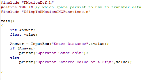

In this program, after the input for keyboard
Answer = InputBox("Enter Distance",&value);
there is a if else clause inside the if and else block there is print command
printf("Operator Canceled\n");
printf("Operator Entered Value of %.3f\n",value);
My question is that where i can spectate the printed line in my flop amd kmotion cnc software.

Post by TomKerekes » Mon Jul 04, 2022 2:51 pm
I don't understand the question. The number the operator entered will be in 'value'
In the above command the operator enters a value which is stored in the value and is assigned to the variable "Answer".
if (Answer)
Next If any value is assigned to the variable "Answer"
then the if block is executed which contains a print statement.
My question is if i execute the program via both kmotion nd kmotion cnc where will the printed statement will be displayed?
No Answer isn't assigned the value. Answer is set based on whether the operator clicked OK or Cancel.
My question is if i execute the program via both kmotion nd kmotion cnc where will the printed statement will be displayed?In both cases the program executes in KFLOP and KMotion.exe Console Screen shows KFLOP printfs. Note printfs are normally only used for debugging. Any final code shouldn't have any printf statements.
