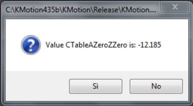

Thanks Tom,
I have modified the tableAC kinematics in order to be sure that it gets parameters from the txt file:
int CKinematics5AxisTableAC::Initialize()
// Check if parameters exist in Kinematics.txt, if so update them and ask for confirmation value window yes/no, no abort
GetParameter("CTableAZeroZZero", &CTableAZeroZZero);
CString str1;
str1.Format("Value CTableAZeroZZero is: %g", CTableAZeroZZero);
if (AfxMessageBox(str1, MB_YESNO) == IDNO) return -1;
GetParameter("CTableAZeroXCenterpoint", &CTableAZeroXCenterpoint);
CString str2;
str2.Format("Value CTableAZeroXCenterpoint is: %g", CTableAZeroXCenterpoint);
if (AfxMessageBox(str2, MB_YESNO) == IDNO) return -1;
GetParameter("CTableAZeroYCenterpoint", &CTableAZeroYCenterpoint);
CString str3;
str3.Format("Value CTableAZeroYCenterpoint is: %g", CTableAZeroYCenterpoint);
if (AfxMessageBox(str3, MB_YESNO) == IDNO) return -1;
GetParameter("ASaddleYCenterpoint", &ASaddleYCenterpoint);
CString str4;
str4.Format("Value ASaddleYCenterpoint is: %g", ASaddleYCenterpoint);
if (AfxMessageBox(str4, MB_YESNO) == IDNO) return -1;
GetParameter("ASaddleZCenterpoint", &ASaddleZCenterpoint);
CString str5;
str5.Format("Value ASaddleZCenterpoint is: %g", ASaddleZCenterpoint);
if (AfxMessageBox(str5, MB_YESNO) == IDNO) return -1;
return 0;
So when you start Kmotion or KmotionCNC you get the following confirmation windows:
If I use mm units in KmotionCNC should I put the kinematics parameters in the txt file in inches or in mm?
