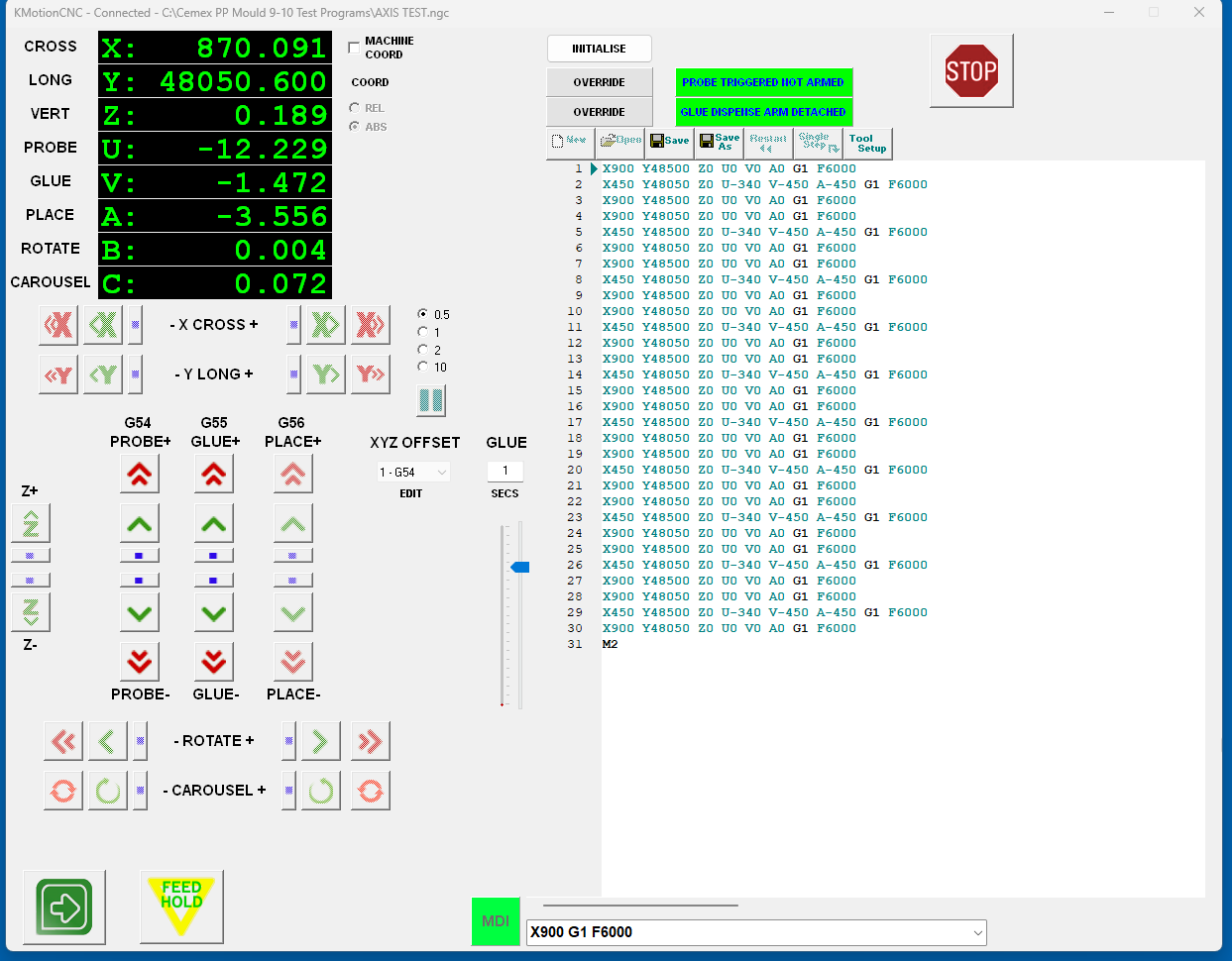

I have tried including in the gather example some of the jog buttons but they do not disable.
The example buttons do disable and can be re-enabled.
I tried the Diable Jog keys but not all are disabled as shown in the attached screenshot.
Ideally i want to disable all the jog keys but not the step keys if i have false probe trigger or the glue arm gets knocked of it's magnetic mount.
This way only the step buttons will be active and only allow small steps until the probe is clear of the trigger point or the glue arm can be re-mounted.
Any help or an addition an example jog keys to Buttons Disable would be appreciated.
