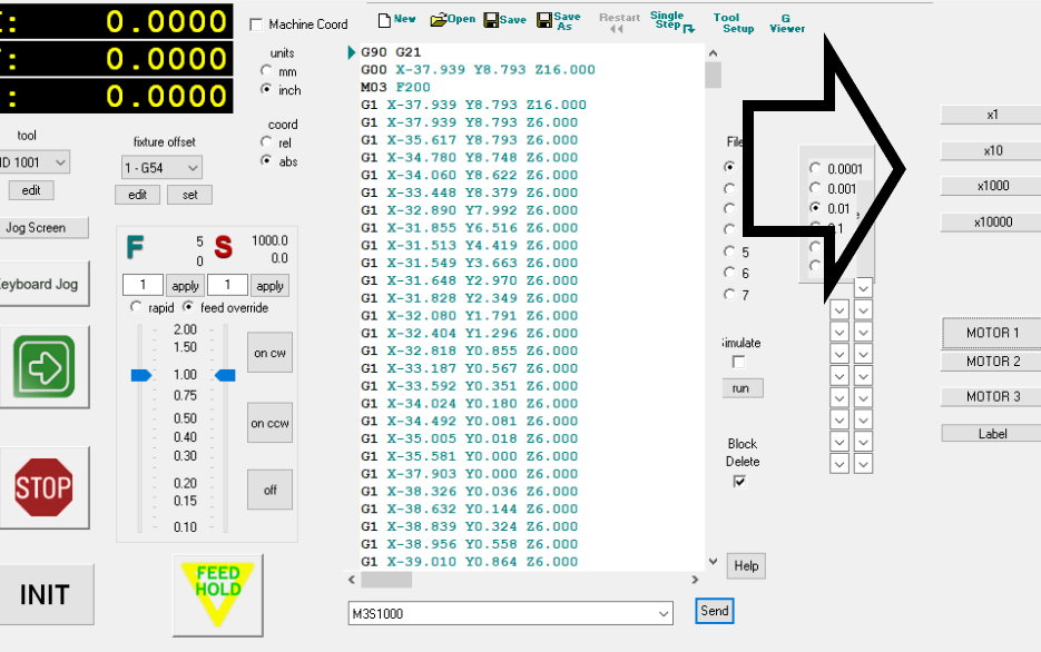

TomKerekes wrote: ↑Sat Oct 31, 2020 12:51 amHELLO, TOM, GREETINGS. I'm trying to put buttons on the KMOTIONCNC screen, I just need them to send me a value that I can use in a C program. Is there a way to do this? I am only using KFLOP.
For example, I have 4 buttons with 1, 10, 100 and 1000, suppose I select the one with a value of 1000 (in my case they would be pulses that I will send to a motor) then when I press the motor button 1 a C program is executed where it reads the value of the selected button 1000,and 1000 pulses are sent to the motor, is it possible to do that?

Hi Ibzan,
There isn't currently a way to read the text of a pushbutton. But if the text doesn't change then you might just code the value into the C Program for the button. Or you might pass the value to the C Program as the Actions Param.
Another option might be to use Edit Controls with buttons right next to them. In this case the C Program activated by the button could read the edit associated control. This would also allow the Operator to easily change the values.
