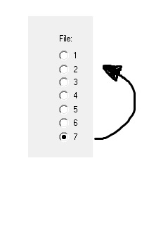

Hi Ivan,
I don't understand the question.
But you can change the selected file number with Screen Script. The code below will select file #2
if (ScreenScript("WinMsg:DlgName;IDC_Thread2;BM_CLICK;"))

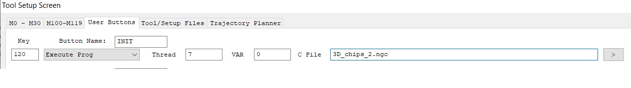

IvanSiberia
- Posts: 30
- Joined: Fri Jun 17, 2022 11:21 am
Re: RUN GCODE
How can I switch the GCODE stream from KFLOP?
- test1.jpg (6.74 KiB) Viewed 9495 times
- Posts: 2931
IvanSiberia
- Posts: 30
Re: RUN GCODE
This method works! Thank you
