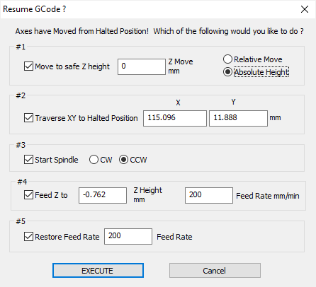

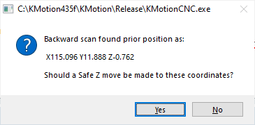

However KMotionCNC does have a Set Next Statement option by right clicking on the GCode line where you would like to start. KMotionCNC then scans backwards from that line to attempt to determine the previous position, feedrate, spindle speed, units, etc
When setting the Next Statement you may receive messages such as:
And then when Cycle Starting you may receive a resume message with certain options as shown below:
Set Next Statement doesn't work with subroutines, or if a different Tool, or GCode Offset, or Plane is required to resume.
