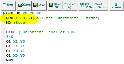

reg pgm.PNG (7.17 KiB) Viewed 3246 times
In the above file the gcode line which is highlighted is used for repeatability of certain gcode block. my question is the gcode line M98 P100 L3
whether i can replace L3 with L#100 where #100 contains no of times the gcode block gets repeated. if do so whether i can save that #100 in vars file and access in this gcode line?
Yes
I don't understand this question. If you change the emc.var file such that it saves and restores var 100, then var 100 will be read from the file on startup and written to the file on exit.
