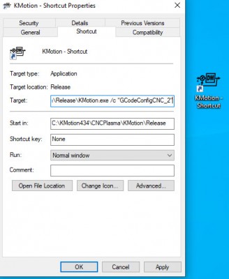

Post by a_j_p3 » Wed Jul 13, 2022 8:42 pm
So I think part of my confusion is that the directions listed here (https://www.dynomotion.com/Help/KMotion ... ations.htm) do not say to create a shortcut for KMotionCNC, instead it says (in bold) to create a shortcut for KMotion.exe.
When I do this for KMotion.exe, at least the creating the shortcut and adding the configuration seem to work; as in I don't get errors. But unless I am missing something it doesn't achieve 2 configurations of KMotionCNC...

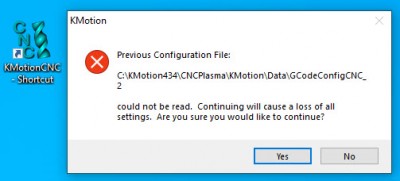

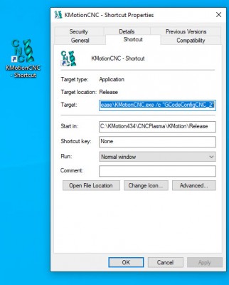

However, your message below says to create 2 shortcuts to launch KMotionCNC and add the configuration files to them, which makes more sense to me... I just can't do it, or am doing something wrong, because if I follow the process on the directions page copied above but with KMotionCNC.exe instead of KMotion.exe

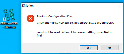

I get the following errors:
I get these errors whether or not I type the below in addition to the target location (it's hard for me to see on the directions page whether or not there are spaces present so I tried several combinations):
- C:\ ... Release\KMotionCNC.exe /c GCodeConfigCNC_2
- C:\ ... Release\KMotionCNC.exe /c "GCodeConfigCNC_2"
- C:\ ... Release\KMotionCNC.exe /c"GCodeConfigCNC_2"
- C:\ ... Release\KMotionCNC.exe/c"GCodeConfigCNC_2"
And I do currently have two configuration files in the C:\KMotion434\KMotion\Data folder
Am I just super confused and doing something really wrong following the directions that are written out? Would it be easier to just install a second instance in another directory? Or what is the best way for me to resolve this?

So I'm not positive why the installation went to that folder - I unistalled/reinstalled when I had issues trying this the first time and the reinstallation defaulted to that folder I had created. Everything worked fine so I decided not to mess with it. The errors that I am getting now are the same ones I had before uninstalling.
Here is a copy/paste of the target for KMotionCNC: C:\KMotion434\CNCPlasma\KMotion\Release\KMotionCNC.exe /c "GCodeConfigCNC_2". This causes those errors I posted images of in my previous post.
However here is a copy/paste of the target for KMotion: C:\KMotion434\CNCPlasma\KMotion\Release\KMotion.exe /c "GCodeConfigCNC_2". This works for me. As far as I can tell the only difference between these two is which .exe is being called.

My apologies I provided incorrect info. KMotion.exe does not support specifying a configuration file to be used. It always uses GCodeConfig.txt. Any \c option is ignored. Hence no error for it.
Its still not clear if things are consistent.
and you show the 2 files but I can't see what folder they are in.
but then your last post states:
That's a different folder structure. So KMotionCNC would be expecting to find file in:
C:\KMotion434\CNCPlasma\KMotion\Data
not
