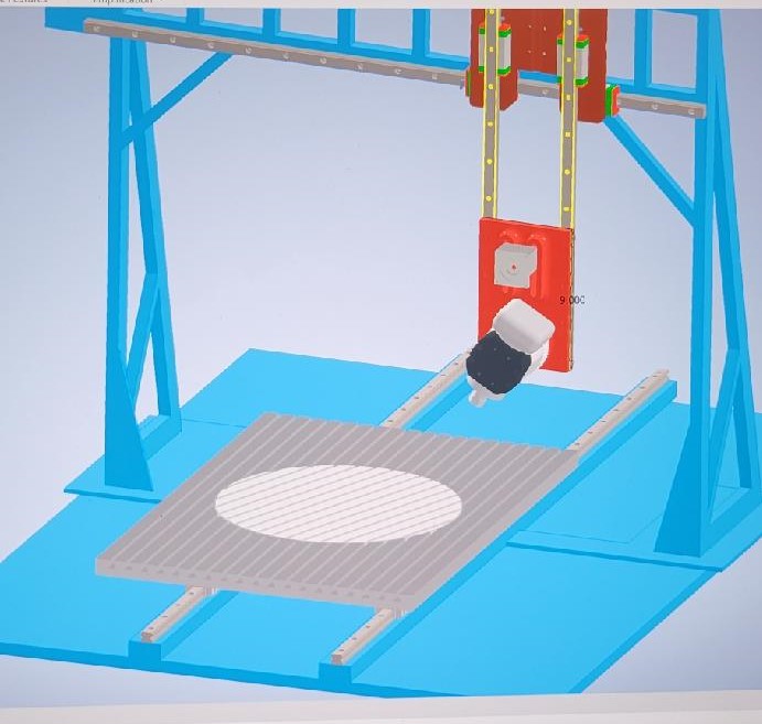

I was still getting too much bearing play through a weak design and the wiring situation gave me nightmares. Also took out a KFLOP board via a voltage spike! So I have decided to go to tilting B axis in the head and a C axis rotary table built into the table. This way I can have a continuous C axis and most to all of the cables can be statically placed. Will look like this.

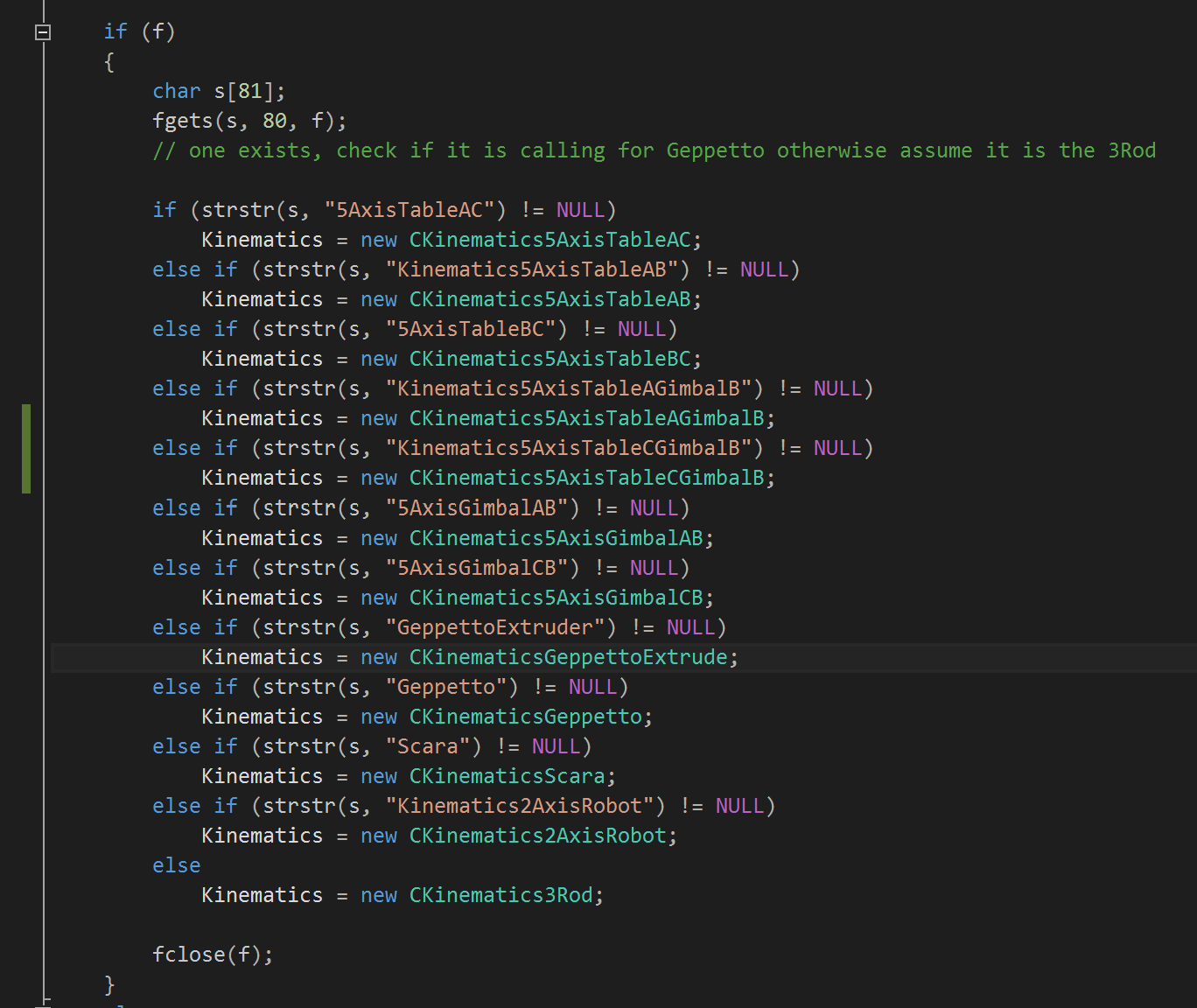

Copied and renamed the TableAGimbleB .cpp and .h files in their root directory to TableCGimbleB. Did a replace all for changing the variable names over in the respective .cpp and .h files. Added the class in CoordinateMotion.ccp and STAfx.h. Made the changes in the code as Tom illustrated. Was able to successfully build the solution!

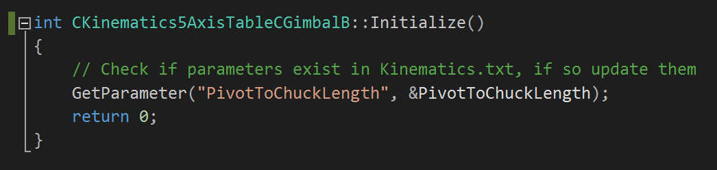

Just an FYI to others who may be reading this.
Code has been put in so that if there is a line in the Kinematics.txt about pivot-to-chuck length it will update the corresponding variable. This will be very handy in getting the system set up or whenever the spindle has to be remounted!
Correct me if I am wrong.
I think you are correct.
