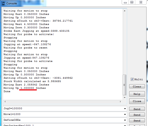

In reference to the ProbeMain.c file discussed here https://www.cnczone.com/forums/dynomoti ... ripts.html, I cannot seem to find how I can specify at the end of the probing cycle for Z not to do this "Moving Up 1.000000 Inches" after is calculates the Stock Width.
I would like for the probe to move to the center and not move up an additional 1 inch at the end. See console screenshot attached.
Thank you kindly,
Cyprian

Post by TomKerekes » Mon Apr 05, 2021 5:04 pm
Hi Cyprian,
I believe you would remove:
MoveDirection(Up, SAFEZ, 0);
from
		case OUT_CENTER_HOR:
			printf("OutCenterHor\n");
			if (GetStockSize()) return;
			FindZ();
			MoveDirection(Up, BUFFERDISTANCE, 0);
			if (FindOutCenterNS()) return;
			break;

Post by cyprian21 » Tue Apr 06, 2021 1:20 am
Thank you Tom,
The SAFEZ did the trick, I went and commented out every SAFEZ just to make sure it was removed on all probing cycles.
Thank you!
Cyprian

Post by TomKerekes » Tue Apr 06, 2021 2:33 pm
Hi Cyprian,
Great, but you might want to be careful. Some of the SAFEZ moves were used to move the probe above the stock so the probe center could be moved right over the edge or over the stock. So removing it might cause a crash. I think if the move is at the very end of the sequence then it should be ok to remove it.
