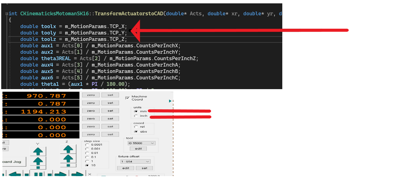

I am having a similar problem, when choosing the mm or inch option the TCPX, TCPY and TCPZ parameters change, is there a way to get the value in mm regardless of which option it is on?
I appreciate any help, greetings.TomKerekes wrote: ↑Wed Aug 26, 2020 3:38 pmHi dd,
Internally the Coordinated Motion Libraries and Kinematics always work in inches. A Machine Operator should never be involved with any of this once the machine is configured and working.
The GCode Interpreter, GCode, and Offsets (Tool, Fixture, and Global) work in whatever mode is selected mm or inches for the current Job.

The TCP Parameters (all internal variables) are always in inches. So to convert to mm multiply by 25.4
The Interpreter assumes the Tool Table values are in the same units of the Job.
So for example: if the Tool Table specifies a Tool Length of 10 and a mm Job is executed it assumes a length of 10mm so passes 0.3937 inches to the Kinematics
if the Tool Table specifies a Tool Length of 10 and an inch Job is executed it assumes a length of 10inches so passes 10 inches to the Kinematics.

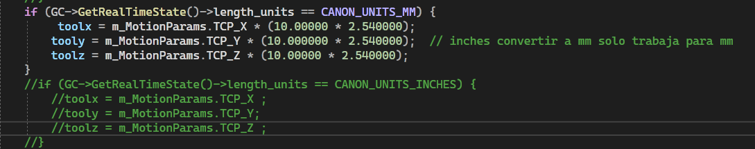

If you want to do something different you might check the current units of the Job and do something different. With:
if (GC->GetRealTimeState()->length_units == CANON_UNITS_MM) ...

Thank you very much, now I understand that part.
Still, the code is very helpful.
