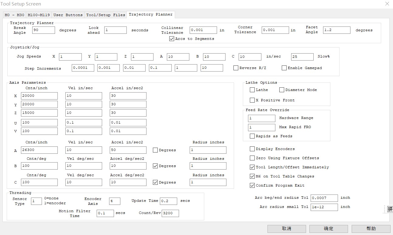

I think this may because the two z-axis step motors move too quickly due to the gcode, isn’t it? Because in initialization c program they work fine. And they always work fine too when I click the green jog button of KmotionCNC. But how can I solve it? I think maybe I should reduce the motion speed of z-axis, but how can I do it without change the gcode program? I guess I should change the configuration in: “Tool setup-trajectory planner-Axis parameters”, is this right? In addition to this method, can we add some encoders in z-axis to constitute a close loop system and use the configuration of “Ch->MaxFollowingError” to limit the out of sync? Now this option is set as:1000000000 because there are no encoders now.

Findally, I attach my trajectory planner screen here:
It all depends on what type of system you have. But 10 inches/sec is quite fast for a stepper motor based machine. Also 30 inches/sec^2 acceleration is fairly aggressive.

Yes, after I decrease the feed rate and the v, A, j value in Trajectory planner. The problem is solved. Thank you.
