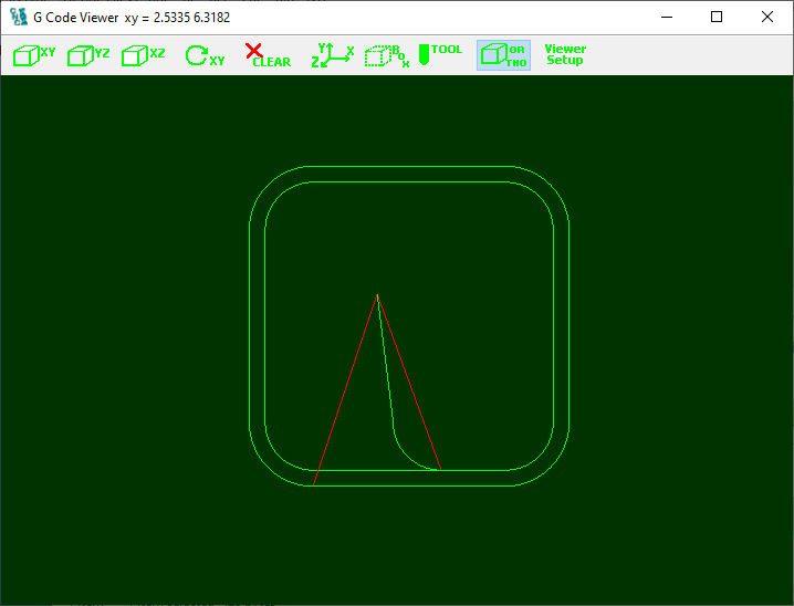

i would like to get some experience with this but cant get the G41 to work
can dynomotion do the G41 P0.1 input? or more like G41 and D1?
quick example i am getting an error on
G20G17G90G94
N7S500M03
N8G00X-8.55Y-0.775Z0.5M08
N9Z0.01
N10G01Z-0.305F90.0
N11X-7.75Y-0.775F3.0
N12X-1.48Y-0.775
N13X-1.48Y-0.555
N14X-7.75Y-0.555
N15X-8.45Y-0.555

Hi Scott,
Looks like you forgot to turn off Radius Compensation with G40.
See the example: ToolRadiusInternalContour.ngc
It demos a path with and without compensation turned on.
Note you might want to select the Fanuc mode of compensation entry mode. See the wiki.

i think i just learned i am screwed for cutter comp :cry:
i have an internal pocket i cut out with a key seat cutter and it just goes in a square contour
matt ( not scott)

G20G17G40G90G94

OK I THINK I GOT SOME WHERE TOMORROW I CAN TEST SOME CUTS!
