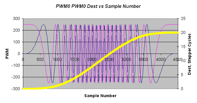

An Excel plot of the captured data is shown below.
