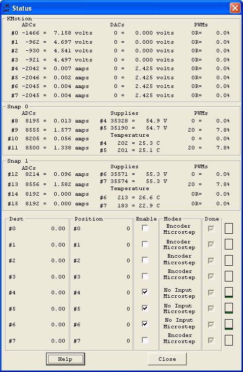

The middle portion of the Analog Status Screen displays the measured currents, supply voltages, temperatures, and current PWM settings.

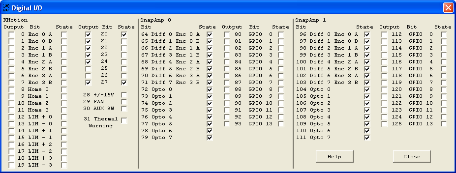

The Digital I/O screen displays the IO bits (numbers 64 - 93) for SnapAmp 0 in the middle portion of the screen, and IO bits numbered (96 - 125) for Snap Amp 1 on the right portion of the screen. The original KMotion I/O bits remain on the left portion of the screen. Note that KMotion I/O Bits 20-28 are used for the high speed communication to the SnapAmps and may not be used as user IO.
